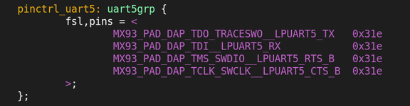

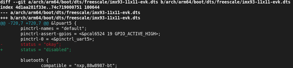

Step-2 :- Enabling JTAG debugging in Linux
On iMX93EVK LPUART5 is MUX'd with the JTAG pins
so if we want to debug the linux kernel via JTAG, we will have to disable it.
Go to the device tree source file -
arch/arm64/boot/dts/freescale/imx93-11x11-evk.dts
Change the status of the following node to 'disabled'

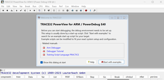

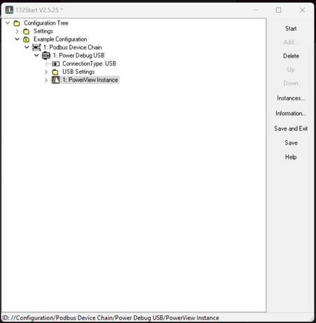

Step-3 Connect the USB cable of Lauterbach Power Debug probe to your windows machine and Open t32 - C:\T32\bin\windows64\t32start.exe
Select 'PowerView Instance' and click on 'Start'. A window like below will appear: -

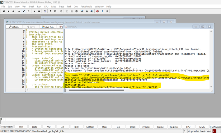

Step- 4 Extract MMU translation info for the debugger
For this either you can execute the below commands on the T32 in sequence: -
RESet
SYStem.RESet
SYStem.CPU IMX93-CA55
SYStem.JtagClock 10MHz
SYStem.CONFIG.DEBUGPORTTYPE JTAG
SYStem.Option EnReset OFF
CORE.ASSIGN 1. 2.
SYStem.Option MMUSPACES ON
SYStem.Option IMASKASM ON
SYStem.Mode Attach
Data.LOAD.Elf <path_of_vmlinux> /NoCODE
DO ~~/demo/arm/kernel/linux/board/generic-template/detect_translation.cmm
OR
simply edit the attached cmm script - detect_address_translation.cmm and modify the <path_of_vmlinux> as per your file location. Then execute it like this:-
Do <file_path>/detect_address_translation.cmm
In my case, this command was: -
Do C:\Users\nxg05261\Documents\cmm_scripts\detect_address_translation.cmm
Note:- <path_of_vmlinux> in my case was  C:\T32\demo\arm\bootloader\uboot\vmlinux. You can modify it as per the location where you have copied 'vmlinux'
-- After executing the above commands, debugger address translation will be displayed: -
Now we will copy the above highlighted lines and paste it in the final cmm script that we will use for debugging. For readers' convenience this info has been collated into the final script - 'linux_attach_t32.cmm', attached with this blog.

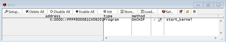

-- Set a breakpoint at start_kernel
b.s start_kernel /Onchip
[Optional]Check the breakpoint via 'b.l'

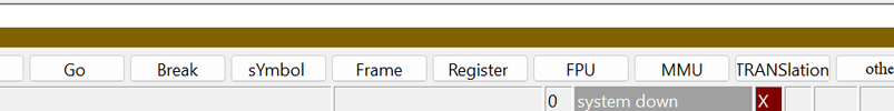

-- Enter 'reboot' at Linux prompt and stop at Uboot command line prompt
you will see trace32 at 'system down' state: -

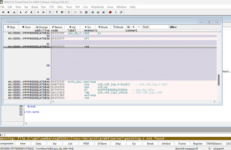

The last print you will see on the serial console will be: -
"Starting kernel …'

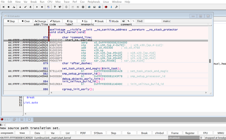

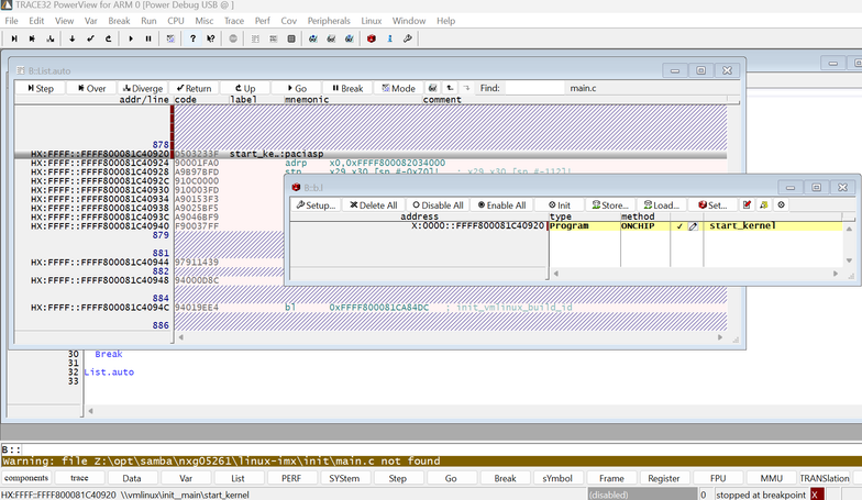

the execution will stop and at t32 you will see that the breakpoint is hit, meaning the Program Counter is at the address of the function 'start_kernel'

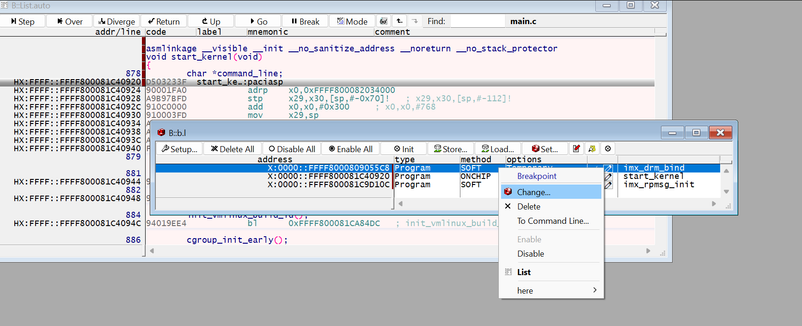

Note- The Warning that you might observe[like in the above picture] means that trace32 is not able to find the source file 'main.c'. So you will not be able to see the 'C' source code at this point. To resolve this:-
-- Right click on the 'List.auto' window where you see the assembly code. Click on 'Resolve Path' and navigate to the init/main.c in your kernel source code folder and click Open. You would see that the source path translation is now correct and you're able to view the disassembly as well as the source code: -

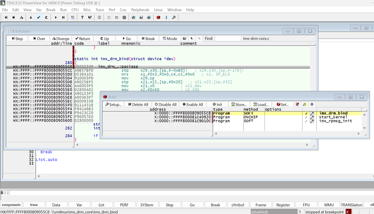

-- Apply breakpoints at t32 window

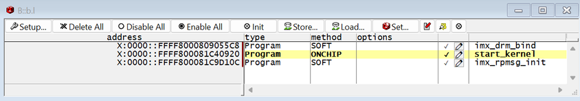

b imx_rpmsg_init
b imx_drm_bind
[Optionally] you can verify the breakpoints via 'b.l'

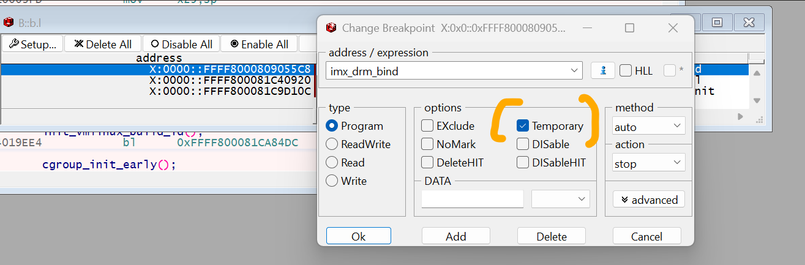

These breakpoints are temporary as you can see in the above snapshot. That means after they are hit, they will be removed, so to make them permanent:-
Right click the breakpoint -> Change -> Uncheck Temporary -> Click Ok
like depicted in the following snapshots: -

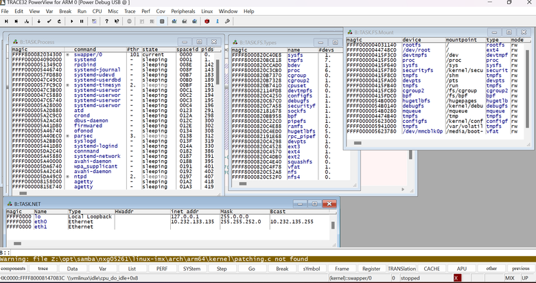

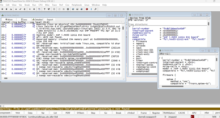

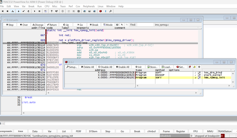

Now, to reach the next breakpoint, execute 'go' on the t32
At this point linux kernel execution has reached the function imx_rpmsg_init
Again, to reach the next breakpoint, execute 'go'
So this is how you start debugging the linux kernel. Apart from this, there is a nice t32 feature called 'linux awareness' which allows you to easily debug the kernel loadable modules, user space applications amongst other things. To explore 'linux awareness', you can go about checking the 'Linux' drop down menu present at the top. Plenty of support documents are available on the web.
