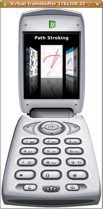

A simple virtual framebuffer will open. To change screen configuration and add a skin, click in "file -> configure". The following window will open:
i.e., choose ClamshellPhone and click ok. A cell phone skin will open.
On QVFb version, there are a lot of example applications that can be run using Qt virtual framebuffer.
Let's open fluidlauncher demo:
cd /usr/local/Trolltech/Qt-qvfb-version/demos/embedded/fluidlauncher
./fluidlauncher -qws
The argument -qws is used to inform that the application will run on Qt virtual framebuffer.

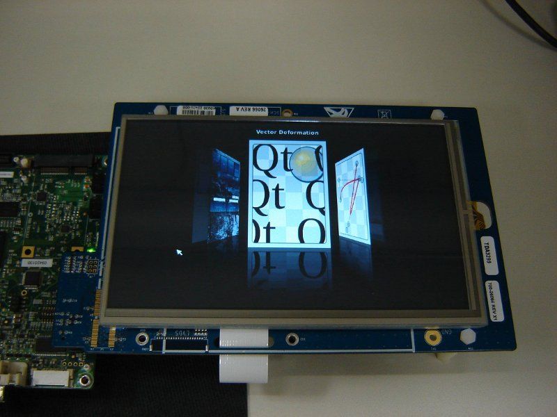

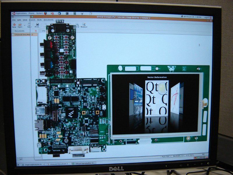

Now it's ready to use. On target, run:
/usr/local/Trolltech/Qt-qvfb-version/demos/embedded/fluidlauncher/fluidlauncher -qws
See some pictures of the same application running on host and on EVK:
