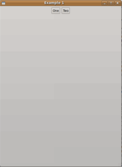

On terminal, compile the source code using ecj:
$ ecj Example1.java
ecj Java Compiler is needed to compile this example. To install ecj on Debian based OS, install the packages: sudo apt-get install ecj ecj-gcj libecj-java libecj-java-gcj
Now it's possible to test the compiled program. Just type on host:
$ java Example1
The following window will be shown:

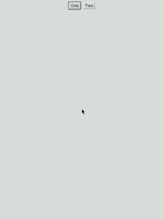

Running on i.MX
Copy the file Example1.class to <LTIB Directory>/rootfs/home
cp Example1.class rootfs/home
On i.MX Linux, start Xfbdev in background:
$ Xfbdev &
Run Example1:
$ java Example1
The following screen will be shown on LCD:
