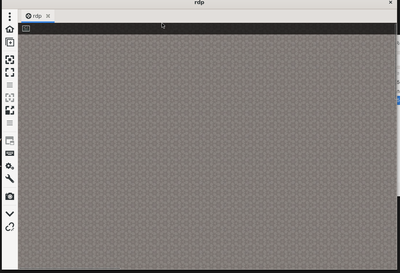

6.Access with Remmina on Ubuntu.
7.Result
