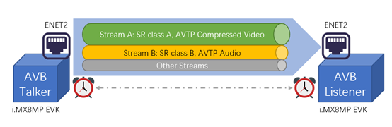

Demo introduction
Two i.MX8MP EVK boards are used for this demo, one act as a AVB talker to send A/V streams, the other one act as a AVB listener to receive A/V streams who can be playback to audio codec and sink video to screen. The two boards are connected by a RJ45 ethernet cable on each ENET2 port (only ENET2 port has TSN features).
Three streams’ type and SR (Stream Reservation) class are defined as below to grantee time sensitive (sub-microsecond synchronization), low latency and bandwidth on the ethernet:
  • Stream A: SR class A, AVTP Compressed Video Format, H.264 profile High, 1920x1080, 30 fps.
  • Stream B: SR class B, AVTP Audio Format, PCM 16-bit sample, 48 kHz, stereo, 12 frames per AVTPDU.
  • Other stream: Best-effort streams
These three TSN streams would be allocated into different traffic control (TC) class for egress in Linux. Different TC class would be mapped to different hardware queues with dedicated DMA channel, thanks to the multi-queue support by ENET_QoS IP. Then the traffic control apply different scheduling policy on each queues for different types of streams egress, to make sure highest priority or critical packet can be sent in the correct time slot.
The TSN streams are transmitted over Virtual LANs (VLANs). Bridges use the VLAN priority information (PCP) to identify Stream Reservation (SR) traffic classes which are handled according to the Forward and Queuing Enhancements for Time-Sensitive Streams (FQTSS) mechanisms described in Chapter 34 of the IEEE 802.1Q standard.

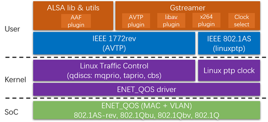

The demo is built up by following blocks:
  • Linux TC (traffic control): streams egress control to meet AVB/TSN requirements, which take advantage of the i.MX8MP TSN ENET IP.
  • Linux PTP: clock sync in network, which take advantage of the i.MX8MP TSN ENET IP.
  • Libavtp: Time Sensitive Applications AV Transport protocol.
  • ALSA: AVTP audio format plugin uses the libavtp to transmit and receive AVTP audio PCM streams.
  • Gstreamer: avtp plugin uses the libavtp to transmit and receive AVTP audio/video streams (video should be encoded as H264, audio PCM). x264enc and libav is a software H.264 video encoder/decoder, which alternative to the on chip VPU acceleration plugin, due to the VPU plugin is not supported in the latest Gstreamer version (1.17.x).

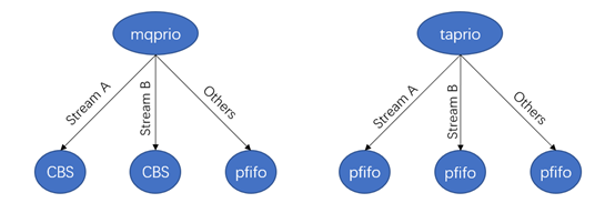

Traffic control
This demo can use two different traffic control qdisc settings:
  • mqprio + cbs: use CBS features
  • taprio + pfifo: use EST and FPE features (802.1Qbu/bv).
The pfifo is the default traffic control class, which use FIFO schedule policy for egress packets. The CBS class is actually handled by hardware IP to select which queue for transmit in a certain time slot.

MQPRIO qdisc
$tc qdisc add dev eth1 parent root handle 100 mqprio \
        num_tc 3 \
        map 0 0 2 1 0 0 0 0 0 0 0 0 0 0 0 0 \
        queues 1@0 1@1 1@2 \
        hw 1
NOTE, since ENET_QoS Q0 does not support hardware CBS, we have to avoid using Q0 for AVB streaming. Here’s the mapping:
  • socket SO_PRIORITY 2 -> TC CLASS 2 -> Q2
  • socket SO_PRIORITY 3 -> TC CLASS 1 -> Q1
  • Other socket priority -> TC CLASS 0 -> Q0

$tc qdisc add dev eth1 parent root handle 100 taprio \
        num_tc 3 \
        base-time 1000000000 \
        sched-entry S 0x6 300000 \
        sched-entry S 0x2 300000 \
        sched-entry S 0x7 200000 \
        flags 0x2
CBS qdisc
Q1 CBS for video, Q2 CBS for audio:
$tc qdisc replace dev eth1 parent 100:2 handle 777 cbs \
        idleslope 98688 sendslope -901312 hicredit 153 locredit -1389 \
        offload 1
$tc qdisc replace dev eth1 parent 100:3 handle 888 cbs \
        idleslope 3648 sendslope -996352 hicredit 12 locredit -113 \
       offload 1
NOTE: By default, the Q0 will be allocated for pfifo qdisc class if we do not define them.
ETF qdisc
As ENET_QOS does not support hardware launch time in IP, the ETF qdisc would not be used here.
