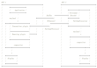

Waltham protocol is a IPC library similar to Wayland, developed with networking in mind. It operates over TCP sockets, while the wayland protocol only works locally over a UNIX socket. It retains wayland-esque paradigm, making use of XMLs to describe the protocol, and it follows an object-oriented design with an asynchronous architecture.

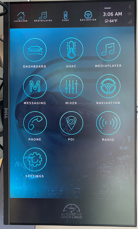

source meta-agl/scripts/aglsetup.sh -f -m imx8qmmek agl-demo
bitbake agl-demo-platform
Then the wic image can be flashed into i.mx8qm showing as below:
