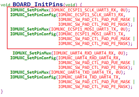

3.1 Pin changes
evkmimx8mp_iuart_sdma_transfer\pin_mux.c

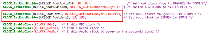

3.2 Clock changes
evkmimx8mp_iuart_sdma_transfer\clock_config.c
In function BOARD_BootClockRUN

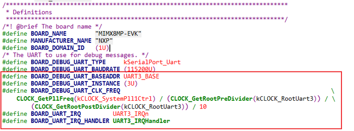

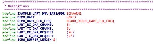

3.3 Application specific changes
evkmimx8mp_iuart_sdma_transfer\board.h
   app.h
Till now, we have completed all the changes for change uart4 to uart3.
Compile , and debug with J-LINK, we can get the correct result.
Board receives 8 characters then sends them out.
However, if we try to load code on Cortex-M from U-Boot or Linux,  we can not get the expected results.   Below steps is a workaround to fix this issue.

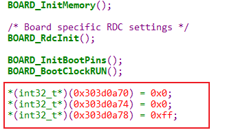

3.4 Memory Region Control change
hardware_init.c
In function BOARD_InitHardware
Then compile the application, the output are  iuart_sdma_transfer.bin and iuart_sdma_transfer_cm7.elf

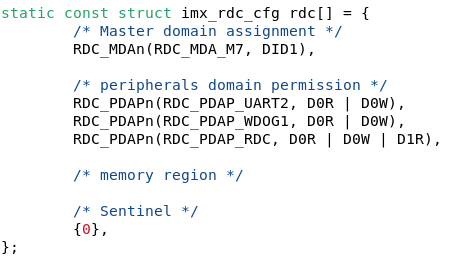

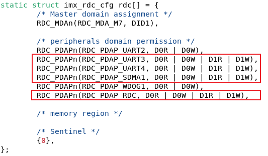

4.1  Download ATF source and Change it
The RDC configuration in default BSP assign UART2 to domain 0 for A53,  and Domain 0 can read/write RDC,  and Domain 1 (M7) only can read it.
$ git clone  https://github.com/nxp-imx/imx-atf -b lf-6.12.3-1.0.0
GitHub - nxp-imx/imx-atf: i.MX ARM Trusted firmware
plat/imx/imx8m/imx8mp/imx8mp_bl31_setup.c
We need to assign UART3 to domain 1 so Cortex M7 can access

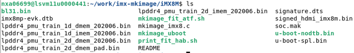

5.2 make imx-boot image by using imx-mkimage
My work folder
The following steps allow you to build the bootable image for i.MX 8M Plus EVK, there are 9 files needed to generate a bootable image:
├── u-boot-spl.bin
├── u-boot-nodtb.bin
├── imx8mp-evk.dtb
├── bl31.bin
├── signed_hdmi_imx8m.bin
├── lpddr4_pmu_train_1d_dmem_202006.bin
├── lpddr4_pmu_train_1d_imem_202006.bin
├── lpddr4_pmu_train_2d_dmem_202006.bin
└── lpddr4_pmu_train_2d_imem_202006.bin
Once you have the nine files , use imx-mkimage tool.
5.2.1  Download source :
$ git clone https://github.com/nxp-imx/imx-mkimage.git -b lf-6.12.20-2.0.0
5.2.2  Copy and rename mkimage from u-boot/tools/mkimage to imx-mkimage/iMX8M/mkimage_uboot.
$ cp uboot-imx/tools/mkimage imx-mkimage/iMX8M/mkimage_uboot
5.2.3 Copy u-boot-spl.bin from u-boot/spl/u-boot-spl.bin to imx-mkimage/iMX8M/
$ cp uboot-imx/spl/u-boot-spl.bin imx-mkimage/iMX8M/
5.2.4 Copy u-boot-nodtb.bin from u-boot/u-boot-nodtb.bin to imx-mkimage/iMX8M/
$ cp uboot-imx/u-boot-nodtb.bin imx-mkimage/iMX8M/
5.2.5 Copy  imx8mp-evk.dtb from u-boot/arch/arm/dts/ to imx-mkimage/iMX8M/.
$cp uboot-imx/u-boot.dtb imx-mkimage/iMX8M/imx8mp-evk.dtb
5.2.6 Copy bl31.bin from Arm Trusted Firmware (imx-atf) to imx-mkimage/iMX8M/
$ cp imx-atf/build/imx8mp/release/bl31.bin imx-mkimage/iMX8M/
5.2.7 Copy the LPDDR4 Training Firmware
Download LPDDR Training Firmware
cd ~/work
wget https://www.nxp.com/lgfiles/NMG/MAD/YOCTO/firmware-imx-8.16.bin
chmod +x firmware-imx-8.16.bin
./firmware-imx-8.16.bin
copy below files from firmware/ddr/synopsys of the firmware-imx package to imx-mkimage/iMX8M/
  • lpddr4_pmu_train_1d_dmem_202006.bin
  • lpddr4_pmu_train_1d_imem_202006.bin
  • lpddr4_pmu_train_2d_dmem_202006.bin
  • lpddr4_pmu_train_2d_imem_202006.bin
$ cp firmware-imx-8.16/firmware/ddr/synopsys/lpddr4_pmu_train_1d_dmem_202006.bin imx-mkimage/iMX8M/
$ cp firmware-imx-8.16/firmware/ddr/synopsys/lpddr4_pmu_train_1d_imem_202006.bin imx-mkimage/iMX8M/
$ cp firmware-imx-8.16/firmware/ddr/synopsys/lpddr4_pmu_train_2d_dmem_202006.bin imx-mkimage/iMX8M/
$ cp firmware-imx-8.16/firmware/ddr/synopsys/lpddr4_pmu_train_2d_imem_202006.bin imx-mkimage/iMX8M/
 5.2.8 Copy firmware/hdmi/cadence/signed_hdmi_imx8m.bin from the firmware-imx package to imx-mkimage/iMX8M/.
$ cp firmware-imx-8.16/firmware/hdmi/cadence/signed_hdmi_imx8m.bin imx-mkimage/iMX8M/
The folder structure after copying all the necessary files

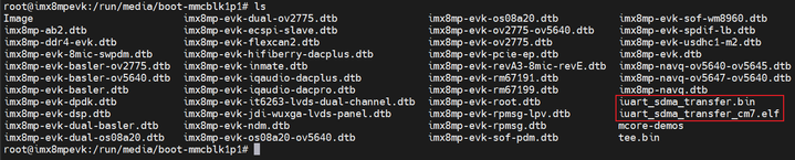

Download the application (iuart_sdma_transfer.bin and iuart_sdma_transfer_cm7.elf) to /run/media/boot-mmcblk1p1

6.2   Debugging Cortex-M while Cortex-A is in Linux
u-boot=> setenv fdtfile 'imx8mp-evk-rpmsg.dtb'
u-boot=>run prepare_mcore
u-boot=>boot
u-boot=>boot
Linux system boot up:
echo /run/media/boot-mmcblk2p1/iuart_sdma_transfer_cm7.elf > /sys/class/remoteproc/remoteproc0/firmware
echo start > /sys/class/remoteproc/remoteproc0/state
Then we can see the output from M7 console.
