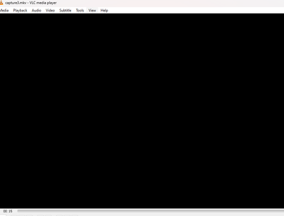

Dump the frame information, then the frames are P frames, there is no IDR frame. Can you check the rtsp source setting?
ffprobe -i capture3.mkv -show_frames -show_packets -print_format json > 1.txt

wellu
video is partial h.265 over RTP and we have no control over the sending end. It very well might be that missing IDR frames cause i.MX 8M Plus decoder to fail where as i.MX 95 and Debian workstation work. It was just wrapped inside Matroska for testing without touching (e.g recoding) the h.265 stream itself.
We just don't know the exact reason but missing IDR frames could be it. As far as I know the h.265 decoding is done in Hantro G2 on MX8MP and other platforms use very different driver code and HW indeed.
We try to get a new stream with proper IDR frames in it and test again. I'll inform you once this is done and thanks for the help so far.

Zhiming_Liu
Hi @wellu
I use below command to repair .mkv you provided, then repaired stream can work on i.MX8MP.
ffmpeg -i capture3.mkv -c:v libx265 -crf 23 -preset fast -c:a copy repaired.mkv

Zhiming_Liu
Hi @wellu
I opened the capture.mkv with VLC/Windows Media Player in x86 Windows11 PC, it also can't be played.
Different platforms have different levels of tolerance for errors in streaming. The fact that the same issue occurs on Windows 11 PCs indicates that the primary issue lies within the RTSP stream itself, rather than in the specific hardware platform.
Is that possible to adjust the camera encoder side?
