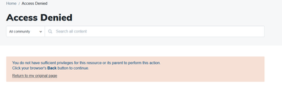

Flo1989
sry but i have no access to that link.
