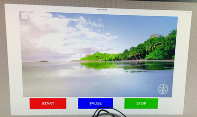

Result
          You can see your Gstreamer video is always on top and you can control your pipeline by press the Start, Pause and Stop button.

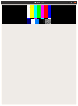

你好!
看到您这篇帖子,可能对我们有所帮助
我们的开发板也是i.mx8mp,内核5.10.9,Qt5,Yocto3.2.0。
开发软件的功能主要是视频播放和控制,需要将视频嵌入显示在widget里面,并且可以改变widget的大小,目前软件在ubuntu上开发是没有问题的,并且也能够正常运行,但是利用i.mx8mp的Qt交叉编译环境编译并运行到i.mx8mp上时,软件会崩溃,并报出Segmentation fault错误,经过问题定位,就是Glimagesink这个插件出现的问题,如果换成waylandsink,软件不会崩溃,但是视频会显示到widget之外
图1 Ubuntu显示效果,是正常想要的效果
图2 i.mx8mp崩溃log
图3 将glimagesink换成waylandsink后i.mx8mp显示效果
非常期待您能回复,如果提供例程或者问题调查方向,不胜感激

Hi, @feiyu
    Could you show the pipeline? And have you tested in other version bsp?
Hi, @inly_huang
Thank you for your response. The issue has been resolved, mainly due to the inability to directly bind Waylandink to Qt Widget under Wayland. The demo code currently used is attached, and the problem has been resolved.
feiyu
