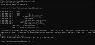

Hello Community,
I have imx8mpevk board and I am referring IMX-MACHINE-LEARNING-UG.pdf file to test the ML frameworks. I have been trying to test the deepviewrt inference engine, but did not get the model in rtm format. Is there any repo where the open source models are converted to rtm format and placed?
I also downloaded the eIQ software toolkit, and was trying to convert the tflite models to rtm model as per the docs shipped with the toolkit. I am however getting the following error,
deepview-converter 2.5.7.post16
FAILURE: No Converter found to convert {m.get('pb')} to {m.get('rtm')}
Can someone help me?
