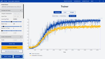

could you please provide some guidance how to move further with object detection application when you have your object detection model already trained with eIQ Portal?
I created example eIQ Portal project (*.eiqp), available at my Github where I described the workflow I followed. I believe it can be a starting point.
The repo also contains the final checkpoint after the training therefore model can be exported. To see model performance and explore the project:
  1. Clone or download the above repo
  2. Open eIQ Portal and choose the eiqp project (in this case fruits_object_detection.eiqp)
  3. Hit Select Model -> Restore Model -> choose checkpoint (only one available) and after that you can see as follows:
Model can be exported using Deploy button.
