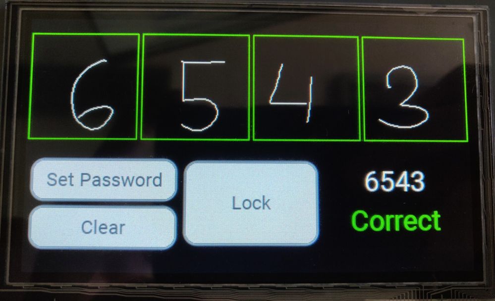

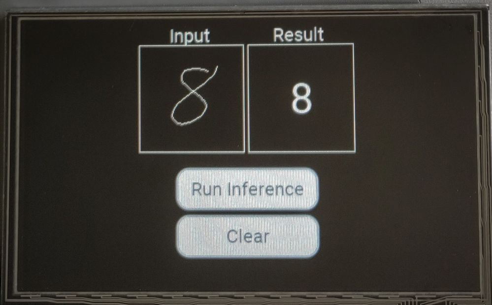

As a case study about CNNs on MCUs, a handwritten digit recognition example was created. It runs on the i.MX RT1060 and uses an LCD touch screen as the input interface. The application can recognize digits drawn with a finger on the LCD.

Application code is in the attached zip files: *_eiq_mnist is the basic application from the first image and *_eiq_mnist_lock is the extended version from the second image. The applications are provided in the form of MCUXpresso projects and require an existing installation of the i.MX RT1060/RT1170 SDK with the eIQ component included.
