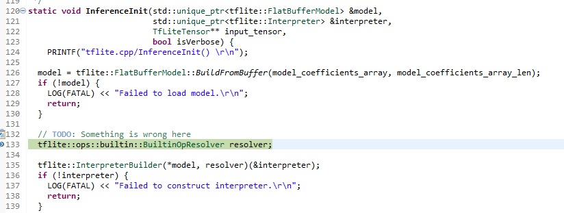

Hello
This is my first project using Tensorflow on and I'm using MIMXRT1062

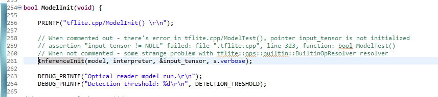

I try to init model this way:
and inside InferenceInit() I create an instance of BuiltInOpResolver

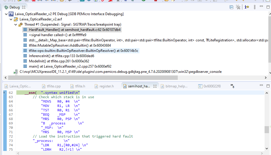

After executing the line highlighted with green my program crashes this way and I have no idea what to do.
Please help

have you tried increasing the Heap memory settings?
I had a similar problem and it turned out my project was using the default Heap size setting (which was about 4KB I think?) and it was not enough for the resolver to init.
I observed the Heap usage in the debugger tool and it looks like resolver initialisation needed about 12KB (in my case at least) but you would probably need more for tensors allocation etc.
hope this would help
greetings
Zuza
