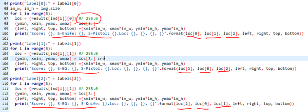

#sort the output array to obtain the best Background, knife and pistol classes scores.
output_data = interpreter.get_tensor(output_details[0]['index'])
results = np.squeeze(output_data)
ind = np.argsort(results, axis=0)[::-1]
#print best 5 Background score results and its location:
print("label[0]:" + labels[0])
im_w, im_h = img.size
for i in range(5):
loc = (results[ind[i]][0]) / 255.0
(ymin, xmin, ymax, xmax) = loc[3:]
(left, right, top, bottom) =(xmin*im_w, xmax*im_w, ymin*im_h, ymax*im_h)
print('Score: {}. Loc: {}, {}, {}, {}'.format(loc[0], left, right, top, bottom))
#print best 5 knife score results and its location:
print("label[1]:" + labels[1])
for i in range(5):
loc = (results[ind[i]][1]) / 255.0
print('Score: {}. Loc: {}, {}, {}, {}'.format(loc[1], left, right, top, bottom))
#print best 5 pistol score results and its location:
print("label[2]:" + labels[2])
for i in range(5):
loc = (results[ind[i]][2]) / 255.0
print('Score: {}. Loc: {}, {}, {}, {}'.format(loc[2], left, right, top, bottom))

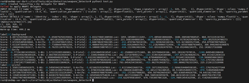

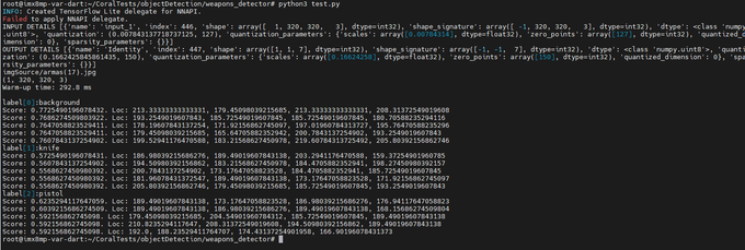

The accuracy of this quantized model is 79.95% according to the validation in the eIQ toolkit . Here however, the maximum accuracy obtained after inference is 0.6235... despite using on purpose an image from the training/validation dataset ( 'imgSource/armas(17).jpg')
In addition, the boxes obtained (object locations) do also not make any sense:
- The input image size is (1300x860) which is first resized to the model´s input size (320x320).
- The output values are then divided by 255.0 (output tensor is of type uint8) and multiplied by the corresponding image sizes: ``(left, right, top, bottom) =(xmin*im_w, xmax*im_w, ymin*im_h, ymax*im_h)´´
I am doing something wrong here, as the boxes are always in pixel ranges between [160 < x < 220] for both height and width (left, right, top, bottom values in the code) which can clearly not be correct.
Any idea, why is this happening or how can I interpret it correctly?
Thank you very much in advance.
best regards,
Jon
21,006件の閲覧回数
Ramson
Hi @jonmg ,
The model accuracy is completely different from inference output. The model accuracy is how correctly the model predicts between the classes. And inference scores shows how much accurate is the bounding box.
For example, In your case you are detecting knives and pistols. Let 5 images are pistols and 5 images are knives. If the model predicts correctly the 4 out of 5 pistol images as pistols and 4 out of 5 knives images as knives. The model accuracy can be estimated as 80%. This has nothing to do with confidence scores.
The confidence score reflects how likely the box contains an object (objectness) and how accurate is the bounding box. If no object exists in that cell, the confidence score should be zero.
Can you try using the non-quantized float model once and check the results? Because if you do so we can get the output tensor as float which don't requires to divide by 255. So that by default the confident scores will be in terms of 0 to 1 and the locations will be in terms of 0 to 320. By doing so, We can get a better intuition of the output ordering and as well as the values that we can understand.

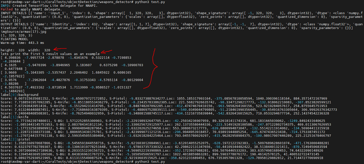

Thanks for the clear explanation. I did the test with the non quantized model as suggested:
The changes performed:
Jon
20,878件の閲覧回数
Ramson
Hi @jonmg ,
Great results. But I'm just wondering how come the scores are not in terms of 0 to 1. Can you please just print the results as you did before :
#lets print the first 5 result values as an example
for i in range(5):
  print(results[i])
And also please mention the input width and height.
Thanks and Regards,
Ramson Jehu K
20,845件の閲覧回数
jonmg
Dear @Ramson,
I included as suggested the first 5 result values as an example, as well as the model's input width and height:
I hope you can help me understand these output values.
Thanks and best regards,
Jon
21,068件の閲覧回数
Ramson
Hi @khoefle , @MarcinChelminsk , @jonmg ,
I kinda figured out what is the output signature of the model with the help of few experts. Correct me if I'm wrong.
If you can notice, the final tensor will be concatenation of two outputs. In this case it would be [1,2034,8] and [1,2034,4] which results in [1,2034,12] .
The model predicts 2034 detections per class. The [1,2034,4] tensor corresponds to the box locations in terms of pixels [top, left, bottom, right] of the objects detected.
The [1,2034,8] will have the corresponding scoring representing probability that a class was detected. For example, lets take the first object detected that is [1,0][8] - this will have 8 values corresponding to probability of 8 classes.
Hope you might find this useful. I haven't inferenced using it personally. Might be great if any of you confirm whether this is correct.
