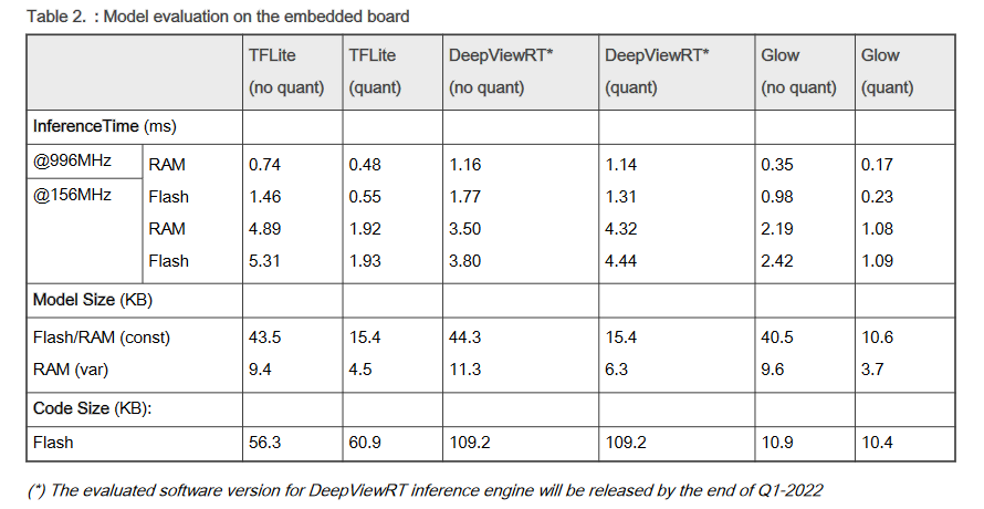

I was reading NXP's blog on Glow compiler for PyTorch at https://medium.com/pytorch/glow-compiler-optimizes-neural-networks-for-low-power-nxp-mcus-e095abe149...
and this blog says i.MX RT1060 used to run Glow and Tensorflow lite for Micro (TFLM) frameworks. Are there any recorded performance benchmarks (inference time, memory consumption, supported operations, etc) to compare Glow and TFLM on the same device? Can you please share it if you have it?

Hello @ramkumarkoppu_p,
one such comparison can be found in AN13562
However, the results are very model dependent. In general, it has been my experience that GLOW outperformed TF Lite Micro slightly but there have also been cases where the situation was reversed. It all depends on the specific layers used in the model, what versions are supported etc. Ultimately, it just comes down to experimentation.
Since it's possible to convert TensorFlow models to ONNX and then compile them with GLOW, you can always train your model in TensorFlow and then compare the performance by converting it both to TF Lite and with GLOW and decide for yourself, which suits your project better.
As for supported operations, that depends on the version of TensorFlow/GLOW currently supported in the SDK. Please have a look at the user guides in the doc folder in the SDK.
I also found this article: https://towardsdatascience.com/tflite-micro-vs-glow-aot-6524be02ba2a which explains the difference between GLOW and TF Lite Micro pretty nicely. It's almost a year old so the data might be outdated at this point but the general idea presented in the article still applies.
