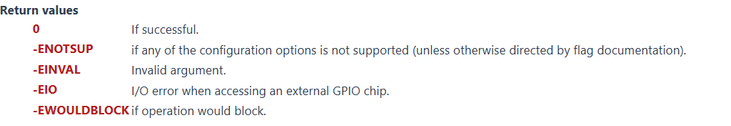

1.  check the return value of gpio_pin_configure_dt (&led, GPIO_OUTPUT_ACTIVE),
int ret = gpio_pin_configure_dt(&led, GPIO_OUTPUT_ACTIVE);
if (ret < 0) {
    printk("Failed to configure GPIO: %d\n", ret);
 Then you can know which error , please refer to Zephyr API

Hi @danielchen, I have already added these statements to my main.c and established that my device is ready. Initially I encountered -ENOTSUP for gpio_pin_configure_dt(). However, I added gpio-reserved-ranges to my overlay file to debug that error. Moving forward, I encountered:
