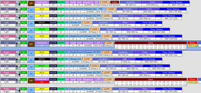

Here is current problem when PC is enumerating USB device (imx8mp-evk USB port 0) with super speed connection. High speed connection is working fine, and PC enumerates USB device successfully.
I capture USB bus trace, and I found USB device controller sent corrupted data for the GET_CONFIGURATION_DESCRIPTOR command. I can see below USB bus capture. The dwc3 sent 32 bytes data but data length is 93 bytes.
I dumped actual configuration descriptor data. You can find data in the bus trace is not matched with actual data.
u-boot=> md.b 802048f0 60
802048f0: 09 02 5d 00 02 01 00 c0 1f 08 0b 00 02 02 02 00 ..].............
80204900: 00 09 04 00 00 01 02 02 00 00 05 24 00 10 01 05 ...........$....
80204910: 24 01 00 01 04 24 02 02 05 24 06 00 01 07 05 81 $....$...$......
80204920: 03 10 00 07 06 30 00 00 10 00 09 04 01 00 02 0a .....0..........
80204930: 00 00 00 07 05 82 02 00 04 00 06 30 0f 00 00 00 ...........0....
80204940: 07 05 01 02 00 04 00 06 30 0f 00 00 00 00 00 00 ........0.......
u-boot=>
Let me know if you need more information. For example, dump registers.

There is no endpoint error event from dwc3 core after start control IN transfer. It received command complete event after start control IN transfer. It means USB controller (dwc3) is processing control IN transfer.

1. Yes, it always happens. For your reference, I attached USB bus trace file.
2. The event 0x060101c2 is command completion event for start transfer command. It is not for the end transfer. It means dwc3 core accepts start transfer command and starting data transfer.
