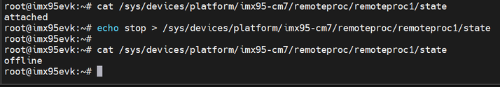

I had to add rpmsg_client_sample.c separately to linux build to generate an imx-image-full image. After copying zephyr_openamp_rsc_table.bin file and generating flash.bin, I booted the board. Post this my module is loaded but not in use. Moreover, my remoteproc's state is attached and I am unable to change the state.
root@imx95-19x19-lpddr5-evk:~# lsmod | grep rpmsg_client_sample
rpmsg_client_sample 12288 0
root@imx95-19x19-lpddr5-evk:~# ls /dev/ | grep rpmsg
rpmsg_ctrl0
root@imx95-19x19-lpddr5-evk:~# cat /sys/devices/platform/imx95-cm7/remoteproc/remoteproc1/state
attached
root@imx95-19x19-lpddr5-evk:~# echo stop > /sys/devices/platform/imx95-cm7/remoteproc/remoteproc1/state
-sh: echo: write error: No such process

danielchen
HI @deepshika_borundiya
please use the latest BSP,  it fixed this issue.
