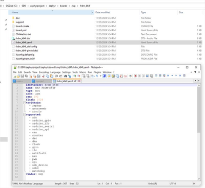

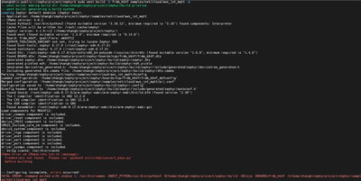

Celeste_Liu
Hello @RenanStarke ,
Sorry for the late reply.
I have updated Zephyr to the latest version. After checking frdm_k64f.yaml, it seems that it doesn't support the aws_iot_mqtt example.
And there will be error messages after using "west build".
So, are you porting the aws_iot_mqtt example to the K64F by yourself?

RenanStarke
Hello @Celeste_Liu,
"I'm using Zephyr 4.1.0, and it works without any modification or porting. The compiler error you saw is related to AWS TLS certificates. Unfortunately, you have to create a "thing" in the AWS IoT Core, place the certificate files into the creds folder, and then run a Python script as indicated in the build error."
Regarding the YAML file, I think it lists the supported hardware, not the sample itself."
