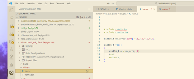

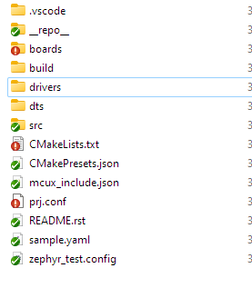

I'm trying to add support for a custom board and custom device drivers (I have an FRAM chip that is not supported).  I have been able to get the custom board to build, but I cannot get my custom driver to build (or to get Kconfig invoked).  I have the following tree:
Or alternate view:
I just need a template to get started with the custom drivers.  I have found an example that is using west directly, but not the mcuxpresso build system.  Does anyone have any experience with this?

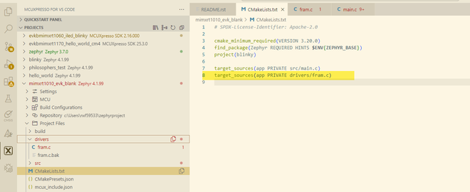

To add custom driver, the simplest way is to edit the Cmakelist associated to your project.
This way, I created the most simple driver on the drivers folder.
Then I called the driver function on main and it worked. This is related to this.
https://cmake.org/cmake/help/latest/command/target_sources.html
I think it is okay for a single file, but for a complete directory not. So I think this could do better the job
https://cmake.org/cmake/help/latest/command/include_directories.html
