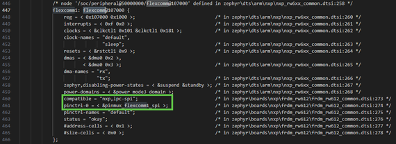

RomanVR
Hello @_arthur_, hope you are doing well.
If you are usign the FRDM-RW612 I would recommend to use flexcomm1 as your I2S instance since it is easy to access through the Arduino headers (J1.15 - I2S DATA, J1.13 - I2S WS, J1.9 - I2S SCK), while flexcomm3 pins are routed to the MCU-Link and trying to use them for I2S would require a re-work.
Regarding your overlay, by default flexcomm1 is used as SPI interface, therefore you would need to change the description of flexcomm1 to be only compatible with "nxp,lpc-i2s" (you can define only 1 functionality for each flexcomm) and add I2S pins defined as "pinmux_flexcomm1_i2s".
Additionally, in order to test your I2S instance I suggest to use the example "i2s_api" which is a testbench that runs different APIs using I2S driver in your board. Note: If you use this example, you need to add an alias "i2s-node0" associated with the modified flexcomm1 definition.

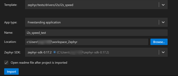

_arthur_
How can you compile and run this example?
I'm using VSCode with the MCUxpresso plugin but when I'm trying to import the project folder, it says there is no project in the folder.

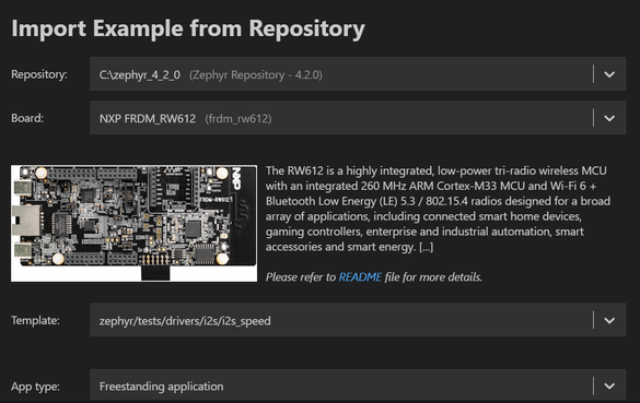

RomanVR
Hello @_arthur_.
Inside the MCUXpresso extension for VSCode click on "Import Example from Repository" in the "Quickstart Panel" view. Here select your repository from your "Imported Repositories" section, the board, and the search for the project in the "Template" section.
Please notice that for Zephyr version 4.2.0 is required to have zephyr-sdk-0.17.2
Please let me know if these steps are helpful.
Best Regards!

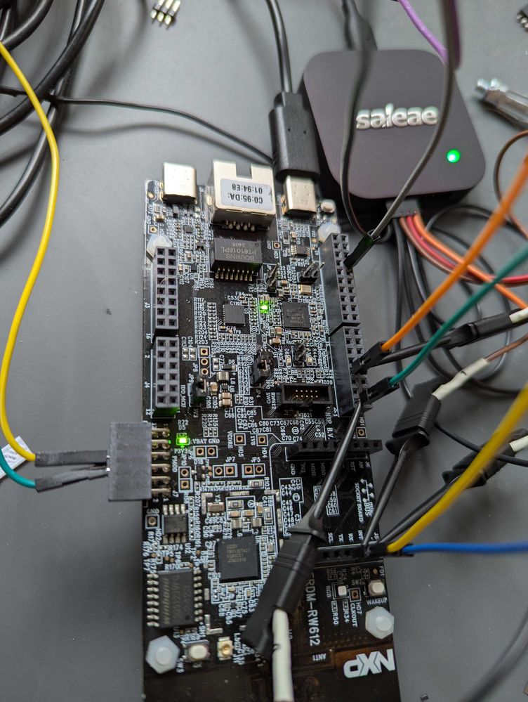

I took some photos of my setup in case you see something obvious. Thanks for your help
8,204件の閲覧回数

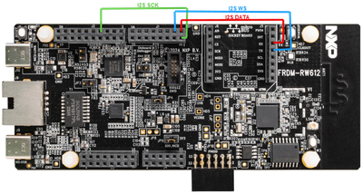

RomanVR
Hi @_arthur_.
I can see some issues with your connections, please refer to the image below in order to do the connections for the example to work properly.
Notice that the example stablishes communication between two I2S  instances (tx and rx) changing the frame frequency at a certain time.
Please let me know if these connections allow you to see the signals.
Best Regards!

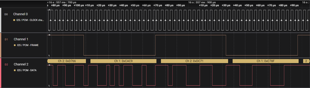

_arthur_
Hello @RomanVR
Ok now I better understand the way connectors on the FRDM-RW612 are connected (or not) based on the onboard jumpers. (you mixed J1 and J2 on your picture but it forced me to look deeper in the frdm_rw612 schematics )
I'm now able to see the I2S signal.
I understand now that FC1 is the transmitter and FC0 the receiver. Unfortunately, it's not exactly my setup for my future custom board. I want FC0 to be the transmitter.

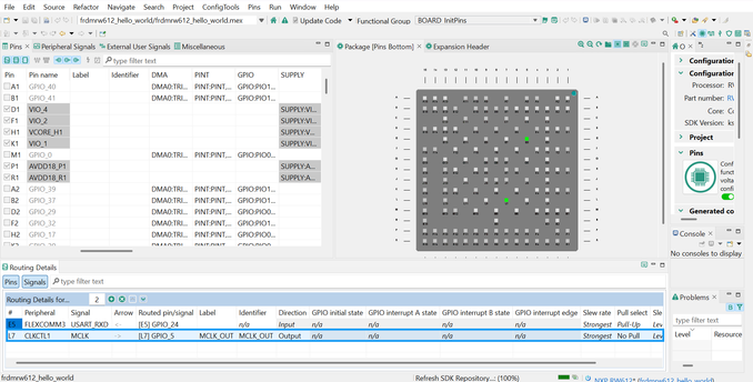

By the way, how can I generate the MCLK (my audio adc needs it) on GPIO_5_MCLK?
Thank you for your help, I can see progress eventually !

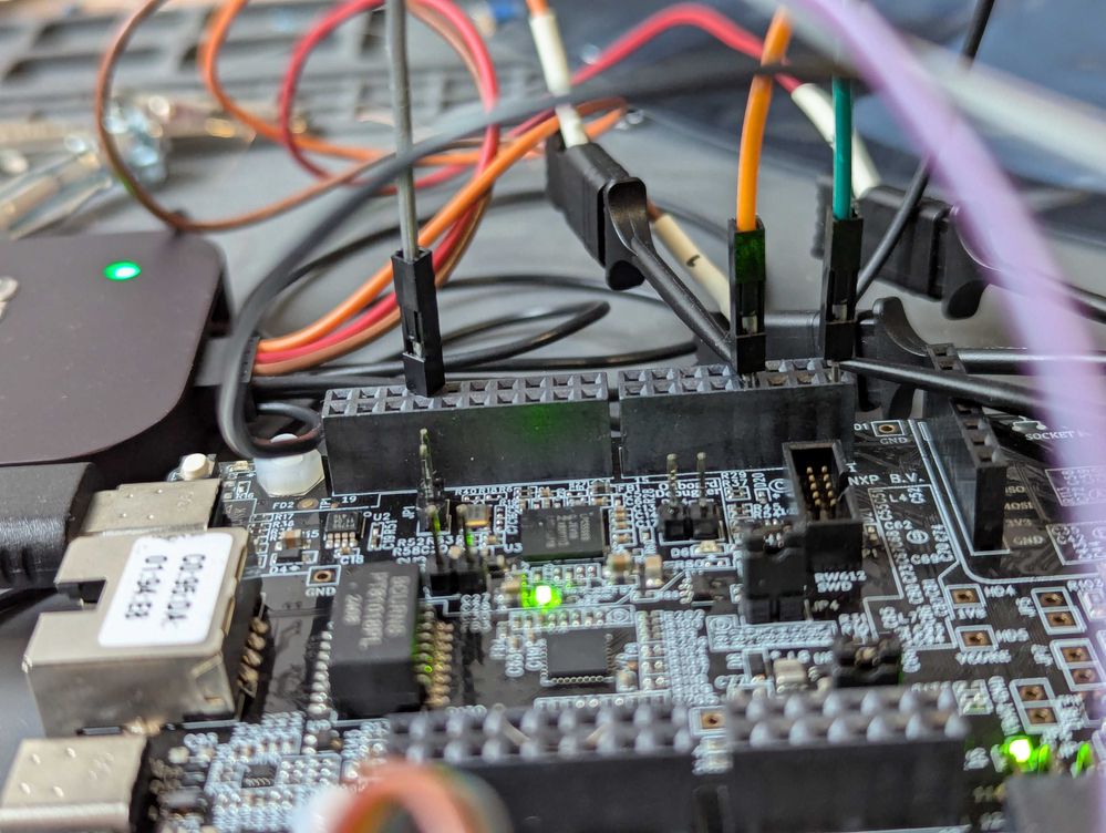

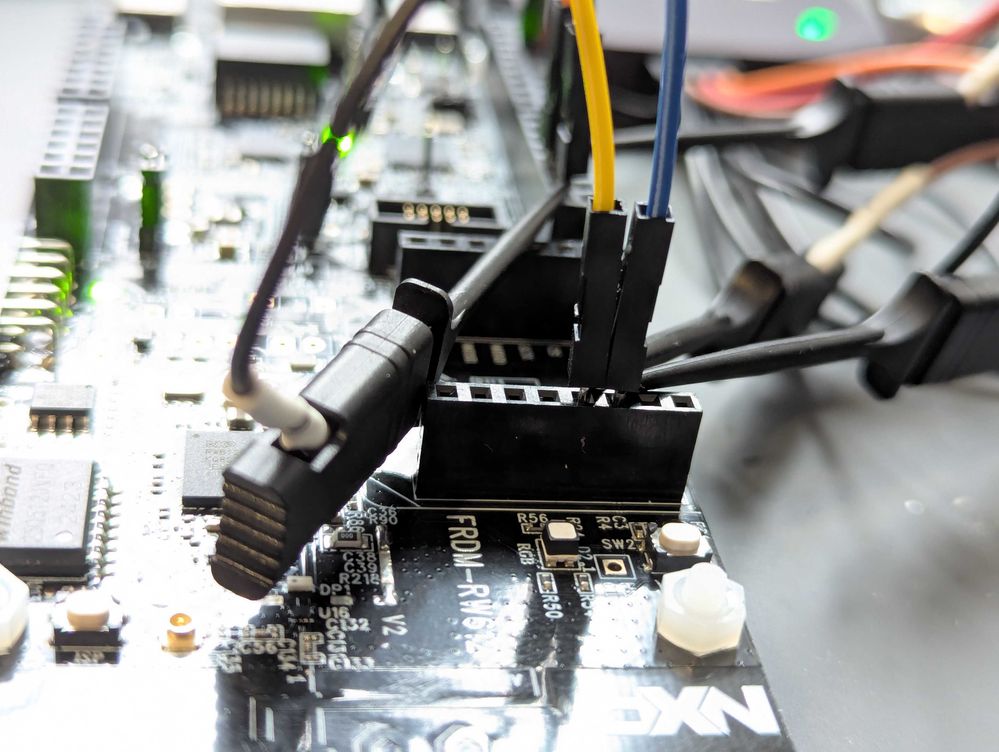

_arthur_
Hello Roman,
I saw you corrected your picture for the connection, the I2S_SCK connection on J2 is still wrong though. It should be the pin 12 not 8.
My mistake was on the connector J5, I used pins 2 and 3 and not 3 and 4.
Now it is working as expected.
What about the MCLK signal. How can I generate this clock for an audio DAC that requires it?
7,949件の閲覧回数
RomanVR
Hello @_arthur_.
Regarding the MCLK generation, I am checking this internally. As soon as I have any recommendation, I will let you know.
Thank you for your patience!
Best Regards!
7,678件の閲覧回数
_arthur_
Hello Roman,
Any news about the MCLK generation? My audio codec cannot operate without it. It uses this clock to run its core.
Thanks for your help,
Arthur
7,086件の閲覧回数
RomanVR
Hello @_arthur_, sorry for the late reply, I hope you are doing well.
In order to add the MCLK output configuration, first you need to generate the required configuration of the MCLK clock and pin, I suggest to do this with "ConfigTools" which is a tool inside the MCUXpresso IDE that allows to configure your MCU's clock tree and pins and writes the API's to do so into the files "clock_config.c" and "pinmux.c" and "pinmux.h". Please notice that MCLK pin has to be configured as well with ConfigTools since it is an RW612-specific feature and it cannot be configured with the Zephyr gpio driver (as it is designed to be generic).
