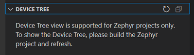

I am working with Zephyr (4.1) samples for i.MX9x and I noticed that, in Visual Studio view for MCUXpresso, the Device Tree panel shows no information - i.e.:
This even after a pristine build. What am I missing?

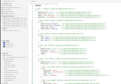

Zhiming_Liu
Hi @TheUncle
Please open dts file in vscode, then the Device Tree view will show.
