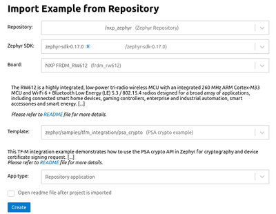

In VS Code, use the MCUXpresso Quickstart panel to Import Example from Repository.
Select the board FRDM_RW612, and the template tfm_integration/psa_crypto.

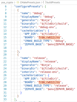

Before building, the project needs to be modified to use the NS board variant.  Open the file CMakePresets.json:
Modify the board name to frdm_rw612//ns for the NS variant.  Save the file.

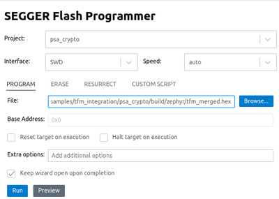

 In the VS Quickstart Panel, launch the Flash Programmer, and select the Segger probe type to use with JLink.
 Select the psa_crypto project, the PROGRAM tab, and browse to the tfm_merged.hex file generated in the sample build folder.  Then click Run.  This programs the firmware image to flash.
