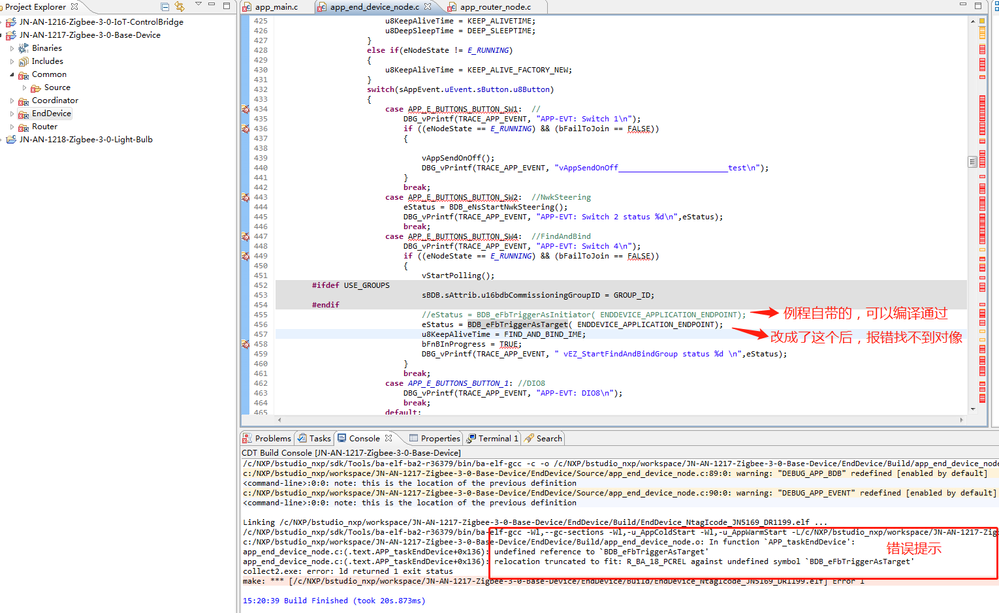

1.i have a problem as The following screenshots
2.JN-AN-1217-Zigbee-3-0-Base-Device  EndDevice

Hi Dylan,
You have to define the BDB Target in the makefile.
#BDB_SUPPORT_TOUCHLINK_INITIATOR_END_DEVICE ?= 1
#BDB_SUPPORT_TOUCHLINK_INITIATOR_ROUTER ?= 1
#BDB_SUPPORT_TOUCHLINK_TARGET ?= 1
BDB_SUPPORT_NWK_STEERING ?= 1
#BDB_SUPPORT_NWK_FORMATION ?= 1
BDB_SUPPORT_FIND_AND_BIND_INITIATOR ?= 1
BDB_SUPPORT_FIND_AND_BIND_TARGET = 1‍‍‍‍‍‍‍
Hope it helps.
