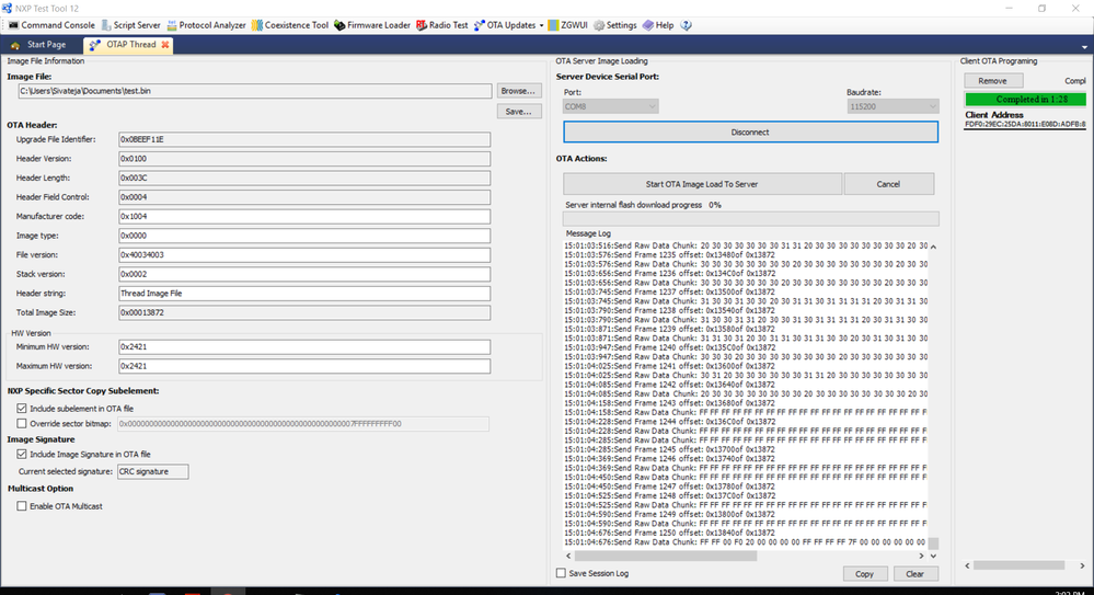

sivatejareddyva
Hello Lillian,
Please look at the image below
I have generated a .bin out of my .xml and started OTA with out looking at the register address which has crashed the client as expected. I think i can flash it with original.
Is there any information about setting up new register address ? can Test tool help in modifying that ?
if it is possible, how do i read the transferred data on the client side ?
Siva

Alexandru-Lilia
Hi Siva,
What you encountered is not a matter of Test Tool configuration, but of the application you have on the client. What happened is that you didn't instruct the application what to do with the received chunk. By default, as mentioned in my previous comment, the function called for the chunk is "OTA_PushImageChunk", which does the following: "Places the next image chunk into the external FLASH. The CRC will not be computed." (extracted from its description). Here is where you add your function that will send on serial line the chunk to the computer.

Alexandru-Lilia
Hi Siva,
If you want to use the OTA approach you have to modify "OTA_PushImageChunk" function call from "OtaClient_UpgradeImage" function, found in *sdk_folder*\middleware\wireless\nwk_ip_1.2.5\examples\common\app_ota_client.c file.
Your function replacement should take the chunk and send it on serial to the destination computer. The function that helps you do this is "THCI_transmitPayload", found in *sdk_folder*\middleware\wireless\nwk_ip_1.2.5\base\thci\thci.c. Define a new OpCode in "nwkOpCode_t" enum found in *sdk_folder*\middleware\wireless\nwk_ip_1.2.5\base\interface\thci.h, so that you would know what kind of message you will get.
Now you have to reassemble the chunks into the file.xml on the destination computer.
Observations:
  • make sure that you have in the project THREAD_USE_THCI enabled on both, the server and the client. (found in .\middleware\wireless\nwk_ip_1.2.5\examples\reed_ota_client\config\config.h)
  • you should use "reed_ota_client" from the SDK to receive the file and "hcd_ota_server" to transfer it. More informations about OTA transfer in *sdk_folder*\docs\wireless\Thread\Kinetis Thread Stack Over-the-Air (OTA) Firmware Update User's Guide.pdf
