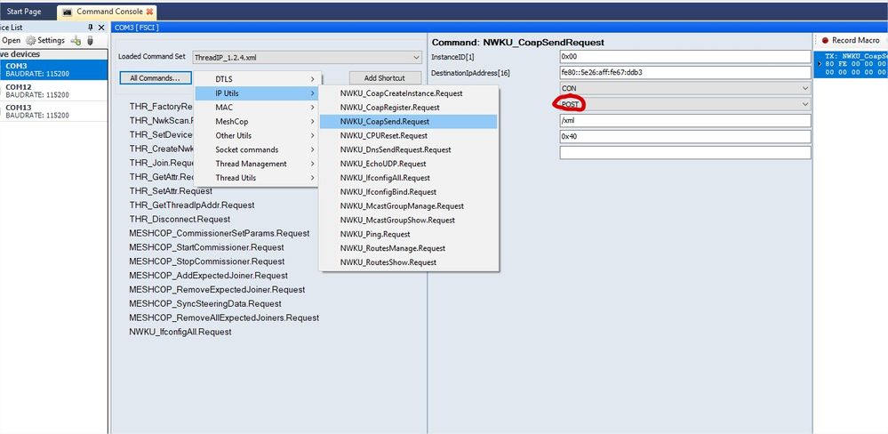

Another approach would be to send COAP messages. Requirements and observations:
  • both devices should be host_controlled_device (not necessary, but recommended)
  • you can simulate the transmission of chunks with TestTool for debug. See the picture attached bellow. You should create URI path for this type of messages, (name it as you want, e.g. "/xml") and use it when you initialize the COAP instance (see function "APP_SendLedCommand" from *sdk_fldr*\middleware\wireless\nwk_ip_1.2.5\examples\reed_ota_client\src\router_eligible_device_app_ota_client.c so you will make and idea how your function should look like); coap_send.jpg
  • now the continuation is similar to the OTA approach; send on the serial the chunks and reassemble them on the computer, see the details above
