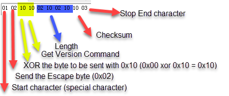

       Use FRDM-KW41 board debug  ZigBee-3-0-ControlBridge project. NXP Test Tool 12/ZGWUI will work well,
       But I want to use COM TOOLS to debug ,The output is garbled/ with 115200(see the attachment). so if I want to use COM TOOLS to debug ,where need set in project frdmkw41z_wireless_examples_zigbee_3_0_control_bridge_freertos.

Please look at the Application NoteZigBee 3.0 IoT Control Bridge.
"SDK_SDK_2.2_FRDM-KW41Z\docs\wireless\Zigbee\Application Notes\AN12063-MKW41Z-AN-ZigBee-3-0-ControlBridge.pdf".
Appendix A: Serial Protocol
Please let me know if you have issues with the commands.
