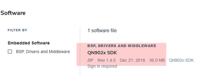

mario_castaneda
Hi @Lin-gy,
Please follow the next link QN9020. Look at the Software Section.
Do you doubt the single carrier frequency problem is caused by the ANT? I shair my PCB layout,Do you have any suggestions?
I am checking the files that you shared, and I will provide if we find any issues or if we could provide any feedback.
Mario
