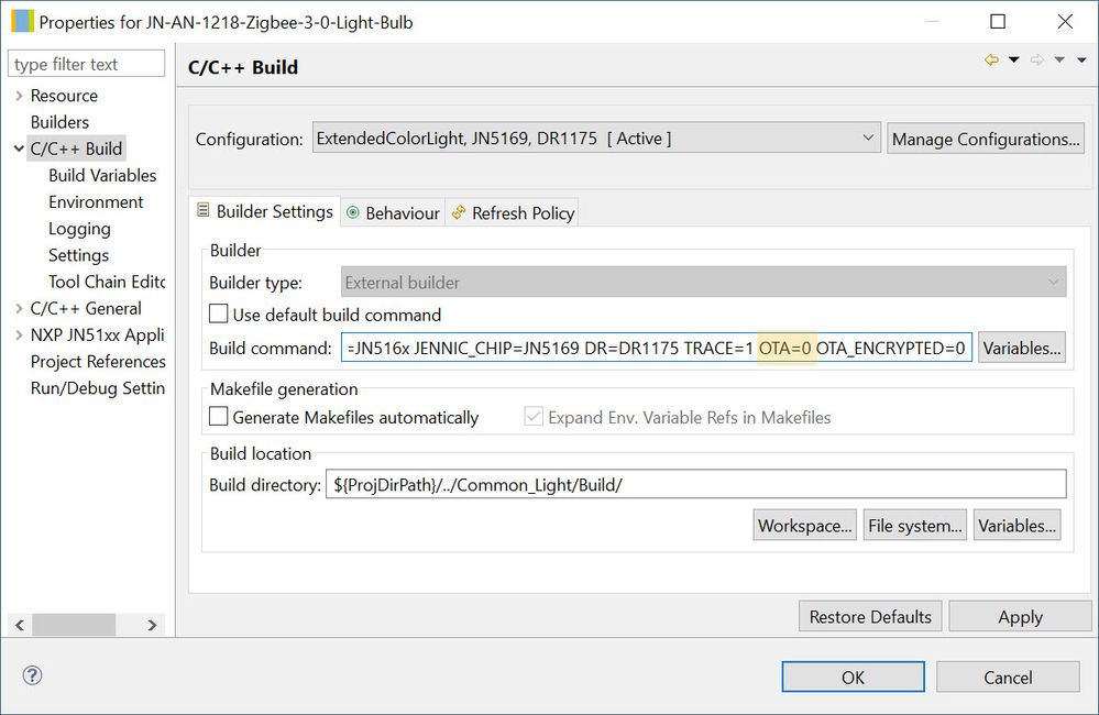

My application have 4 endpoint. If I dont import OTA Upgrade, I still can control these 4 endpoint. But, when I import OTA Upgrade, I can not control any Endpoint, but EP 1.
In UART log, I see error when register EP 2, 3 and 4 with error code is 01 (E_ZCL_FAIL).
Do you know this problem?

Could you please try adding the OTA support from the properties of the project just as the image attached? There might be some missing information either from the makefile or other files that should be added by that definition.

stephanie_m
Yes, using that and adding the OTA=1 definition in the code was enough for it to work.

nguyenanhgiau10
I did like that, but it still get error.
Finally, I find that SDK use the same timer OTA for all EP (OTA.c), it is problem.
Thanks Estephania!

Hi, I got into the same problem recently and just found the same root cause. eOTA_Create function in OTA.c which is called for every registered endpoint calls eOtaRegisterTimeServer. But you want to register time server only once for all EPs not for each of them. Trying to register for each of them causes error as we run out of resources (timers) and regustration of second and subsequent EPs fails. I have manage to fixed it for myself but the question I have is following:

nguyenanhgiau10
Hi witoldsowa
static bool isRegisterTimerOTA = FALSE;
if (isRegisterTimerOTA == FALSE) {
isRegisterTimerOTA = TRUE;
// add timer click function to ZCL
if(eZCL_TimerRegister(E_ZCL_TIMER_CLICK_MS, 0, vOtaTimerClickCallback)!= E_ZCL_SUCCESS)
return(E_ZCL_FAIL);
This is my way.
