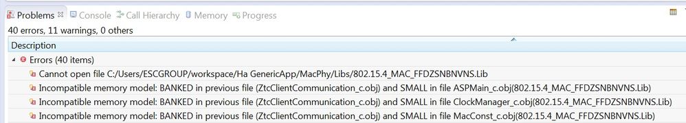

I used beekit to create a Zigbee solucion.
but, this happend:
The problem is with a Lib, but I don't know how to solve it.

Dear Braulio and AngelC
the problem occurs when you select custom hardware, by example
in Beekit
* Select Target hardware "user defined configuration target"
* Edit custom target "MC13237C PiP"
so i think i could be eeprom config problem but not sure.

Dear Braulio,
Could you please specify the Codebase version and application template you are using? Also, please make sure you are using the latest BeeKit release 3.0.2 with updated solutions. Probably you are using an old version of it thus causing such problems.

Thanks for answer.
Beekit 3.0.2(Lastest update) Codebase 3.1.1 , Template Ha DimmableLight with MC13237.
Codewarrior 10.6 and CW 10.5

Dear Braulio,
I just tested a new project using HCS08 BeeStack codebase 3.1.1 and the HA DimmableLight template without any issues at all. I exported the solution to CW10.6 and it compiled flawlessly. Could you please specify whether you selected the default options in Beekit’s project or you changed something else? Please also make sure you have a proper CW license or the evaluation version active.
