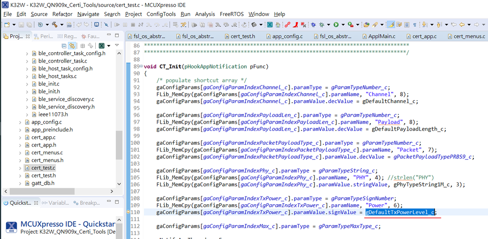

I have found the default value of power, but I cannot find the place where he finally registered.
I want to understand the relationship between register and dbm.
  • KW
2,454 Views
mario_castaneda
Hi Daniel,
You could set the transmission power level in certi tools by declaring as extern following NPI function, and the NPI function range is from -30dBm to 10dBm
extern bool rf_set_power_level(int8_t pwr);
This process is characterized test done on 1 sample, the test data is for reference.
