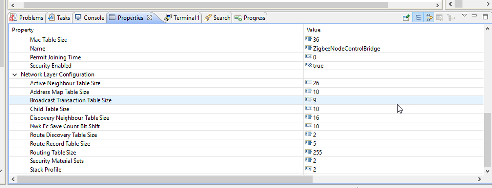

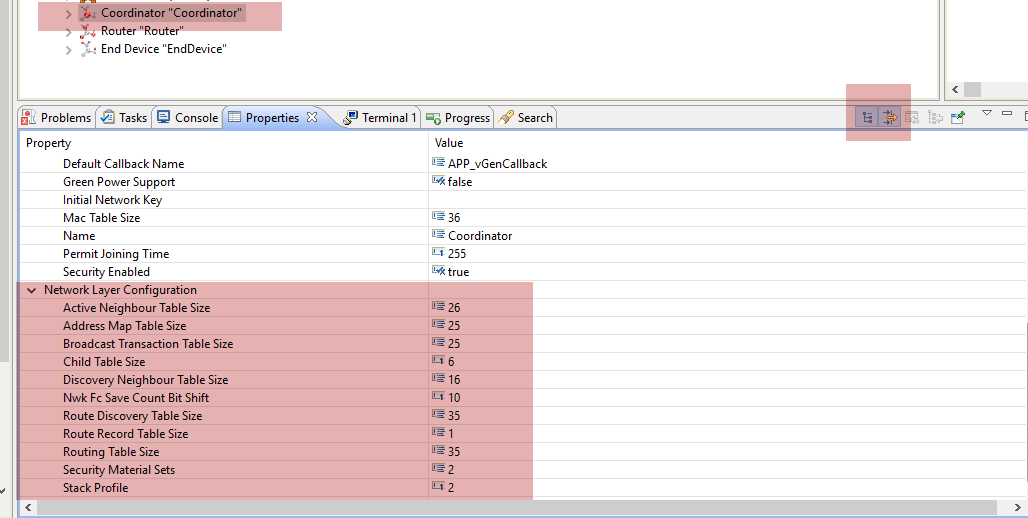

mario_castaneda
Hi Zhou,
Please see the image below, and you would find the Network Layer Configuration. The example provides some values depending on the example.
Mario
8,464 Views
mario_castaneda
It will depend on the device that you are referring to.
The router will have only the devices that are passed through it or the devices that it knows.
The Coordinator needs to store routes to all the nodes in the network if it is required to communicate with every node - in this case, the Routing table size should be increased to the size of the network.
Mario
