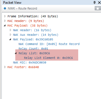

mario_castaneda
Hi Ephraim,
Who is the Trust Center in your network? Do you have the sniffer log? Could you please send an LQI request to the remote control? I want to be sure if the Light is connected directly to it.
Please see the image attached, you will find the route record that is sending by a router, it is saying that knows another router.
Please let me know your findings
Mario

mario_castaneda
Hi Ephraim,
All I need is that my Endpoints will Propagate commands from the Remote Control to the target EP.
Are the other routers Certified by Zigbee? are NXP devices?
If you have a JN device, you could program as a sniffer and use the Ubiqua software to see the packets in the air.
What is the value that the API is returning when the packet doesn't achieve the destination.
Mario

mario_castaneda
1. If there is a piece of software I need to write to enable Mesh Networking?
No, the process that you are following is working
2. Can Mesh Networking established with the modules that I have? (3 End Devices configured as Routers and 1 Remote Control).
Yes, I want to be sure that the routers are updating the routing tables.
3. Is Mesh Networking part of the stack? if yes, what I need to do to enable it?
It is different, the Mesh is supported but you have to be sure that the packets are jumping into the devices, that is the reason for the sniffer log.
Mario

mario_castaneda
Hi Ephraim,
The routing table will be updated if you send a command and this will try to find the destination. If the router doesn't find the route, it will send a broadcast and wait for an answer.
Mario
