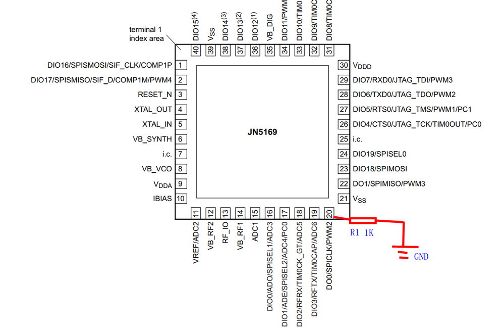

Hi Mario, i have anther problem,
--project: JN-AN_1217-Zigbee-3-0-Base-Device
--ROUTER
1.If DO2 connect to GND, the system fails to start;
2. If i take out the "R1",the system will start normal;

mario_castaneda
Hi Dylan,
The DO0 pin is only output purpose. I am not sure if you are programming but it should be floating.
Mario

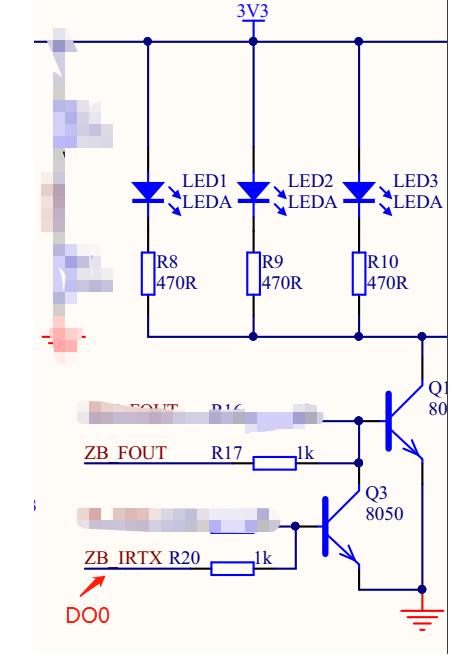

13560436802
Hi mario, the application schematic diagram below, the mark "ZB_IRTX"connect to the DO0;
SO the DO0 generate PWM to drive the LED;
problem:the system can't start. But if take out the "R20",the system can start normal;
By the way, i make a test, if  i connect the DO0 to the GND,the system also can't start;

mario_castaneda
Hi Dylan,
Please re-recalculate the resistance value that is connected to the DO0.
I suggest less value.
