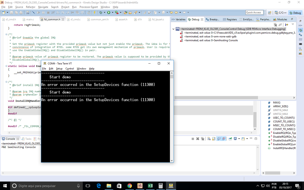

Hello guys!
I purchased a KL43Z development kit with OL2385 and I followed all the steps given by the OM2385 / FS001 development kit - User guide. However when trying to run democonsole, I get the following message "An error occurred in the SetupDevices function (11300)".
I would like to know what error this is, as I have not found documentation regarding this.
Note: The sigfox tower is very close to where I am performing the tests.
Thank you in advance for your cooperation!

ramonribeiro
Hey guys. I have exactly the same issue from you Isabel and I have been following your posts waiting for a answer and right now I figured out. I started the debug from kinetis design studio and import the console project from sigfox driver, as suggested by Mario , and start searching to a function that could change the value of variable status... (that was a little exhaustive) so in file sf.c, I commented all the if statement:
/* Set watchdog timer. */
// if (kStatus_Success == status)
// SF_PackFrame(sfSpiCmdSetWdTimer, SF_SET_WD_TIMER_INF_PLD_B,
// (uint8_t*)(&(userConfig->watchdogTime)), (uint8_t *)spiSndBuf);
// status = SF_SendCommandInt(drvData, SF_SET_WD_TIMER_INF_B,
// SF_SET_WD_TIMER_ACK_B, spiSndBuf, spiRcvBuf, SF_ACK_NOTRANS_TIMEOUT_US);
OBS: I still don't know how this can impact my code/application, if someone could answer me I would be thankful.
I build and started the debug. On the console, I setup the RCZ4, because I from Brazil, as Mario said. But still I couldn't send messages over sigfox so I started a greedy search until I find one. And I got a result in RCZ2 at 902MHZ.
I would like to thank you guys, Isabel and Mario. I have been trying to get this working for a while and I just find answers in this post. I hope that I could help you too, Isabel.

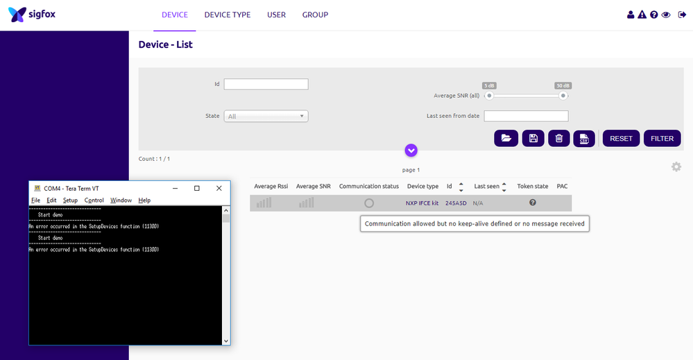

isabelfrota
Hi Mario,
I activated the kit as soon as I got it and got that white status. When you mouse over the status the following message is shown "Communication allowed but keep-alive in defined or no message received"
I really do not know how to proceed because I have followed all the steps correctly.
Thank you for the help!
Isabel

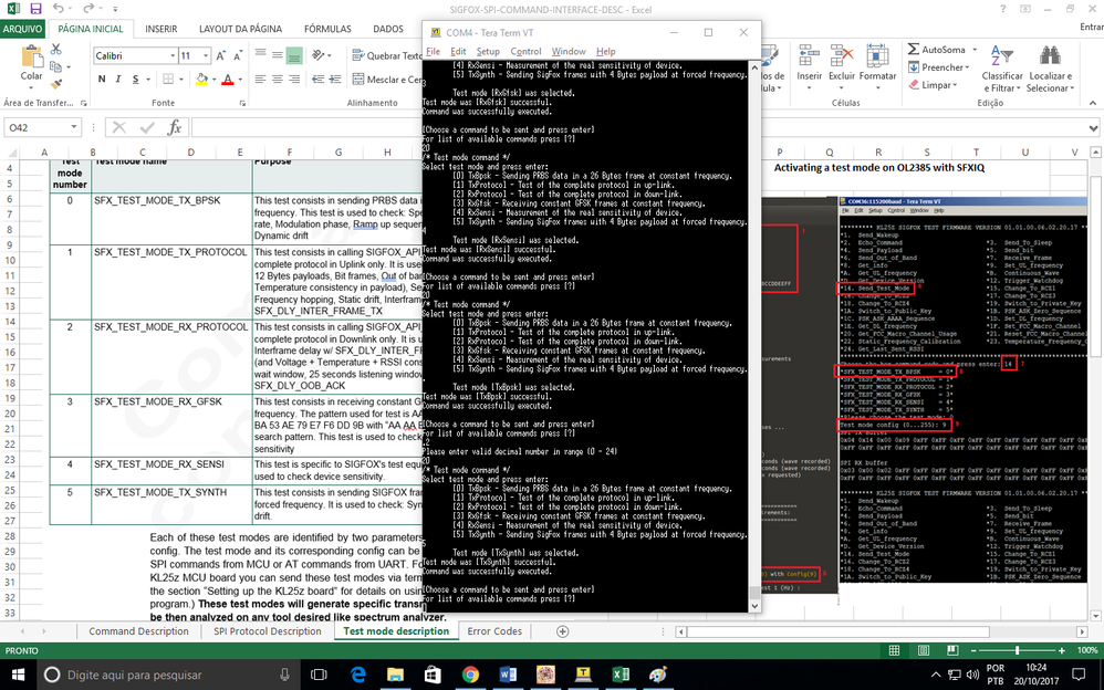

isabelfrota
Hi Mario,
I did what was requested and now I'm even more confused.
All send information commands run without error messages, however nothing changes in the sigfox backend. Also, when you try to run the "Receive Frame" and "Check ID key" commands, there are error messages. I also ran the "Test Mode" and all the commands passed.
     executing "send paylod" without error messages and executing "receive frame" with message error 62
   executing "test mode" with all your options and not show error messages.
Isabel.
