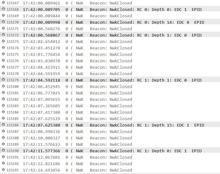

There is another question about customer attached ZigbeeNodeControlBridge.zpscfg in which the MAC Table Size is 36, that can't handle 50ZR+50ZED,
Just to confirm, did you provide the latest .zpscfg file which support 50ZR+50ZED case?
Regarding node leave network, what kind of scenario you are facing when you found the "MgmtLeaveRequest fails, then you send the "LeaveRequest" ?
From the GW point of view, better use Mgmt Leave for both ZR and ZED.
If ZED joins the network via ZR, then only Mgmt Leave is allowed from GW to the ZED according to Zigbee Spec.
Mario

benoit_roue
Hi Mario,
I never sent this capture. Yes, I provided the full log. it is in the first message of this case.
My case isn't about 50ZR+50ZED, you must be confusing with another case.
Regarding the Leave method, I didn't say I have problem with ZED. I just replied your question.
Benoit
