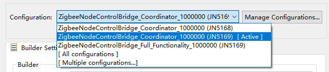

new question:Which one do I choose to compile?

mario_castaneda
It will depend on the application that you want full functionality, the example could support coordinator, router, or end device, depending on the configuration that you make. The bin file will require more memory.
Did you modify the code? What are the changes that you did?

Hi Mario,
I only need a coordinator for the gateway. Do you want to select "ZigbeeNodeControlBridge_Coordinator_1000000(JN5169)"?
