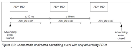

Q1:
      In Bluetooth program development, the device is in scanning mode. I want to get the channel address, 37, 38, 39. Which channel is Bluetooth broadcasting? In the SDK of kw36, which function can get the channel?
      If I only want to receive a fixed channel (37) when scanning, can I? If  I can, where to modify the program?
Q2:  How to understand these parameters?scan interval,scan window
Q3:
       How is the scanning work?Especially in sequential communication?Is it a full scan of channels 37, 38 and 39,Then take a rest and repeat the operation. I refer to the "ble_shell_bm" in the SDK software, and run gap scanstart

1.- It is possible to configure which channels a device will advertise on, by changing the Advertising Parameters Structure in the app_config.c source file.
However, currently there's no implementation to change the channels in which the device will scan for advertising devices.
I'm sorry for the inconveniences this may cause.
2.- According to the BLE Core Specification v5.0, the ScanInterval is defined as the interval between two consecutive Scan Windows.
The ScanWindow is defined as the interval in which the Link Layer is listening on a primary advertising channel index, searching for advertising devices.
3.- Scanning works by starting on a determined channel, like channel 37 for example, scanning that channel for an interval of the ScanWindow value, then waiting for the ScanInterval to finish so it can start scanning on the next channel for another ScanWindow.
