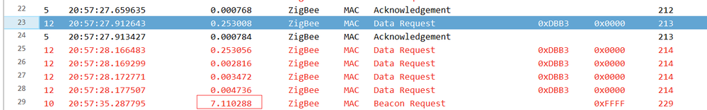

zherlei
hardware:JN5169
software:zigbee 3.0  --- end device
The end device has been added the network built by coordinator. The end device will poll 250 milliseconds once. Sometime, the following phenonmena are as follows when I remove coordinator(poweroff).
bag tool:Ubiqua Protocol Analyzer
The last beacon request is too long to come. This will result in a large amount of electricity consumption.
How can I control the exception?
1,678 Views
mario_castaneda
Remember The time Delta is the time interval between 2 captured packets, which is calculated based on the elapsed time from the previous packet regardless of its source network or channel. are the same device 0xDBB3 and the one that is sending the beacon request?
