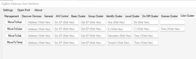

I am using Zigbee Control bridge Application JN-AN-1216. and Following the ZGUI App to control the light colors.  Which has command to set hue , sat and temp etc. I saw people can set zigbee RGB lights in color loops where the RGB light can be set to change colors with some speed continously. What is the command for that ? is it a diffrent command or the move to HUE command with soem special values?

Our SDK supports the Colour Loop feature, unfortunately the ZGWUI tool does not implement this functionality so it cannot be tested this way.
For more details about Colour Loop command, please refer to ZigBee Cluster Library User Guide (JN-UG-3077).
