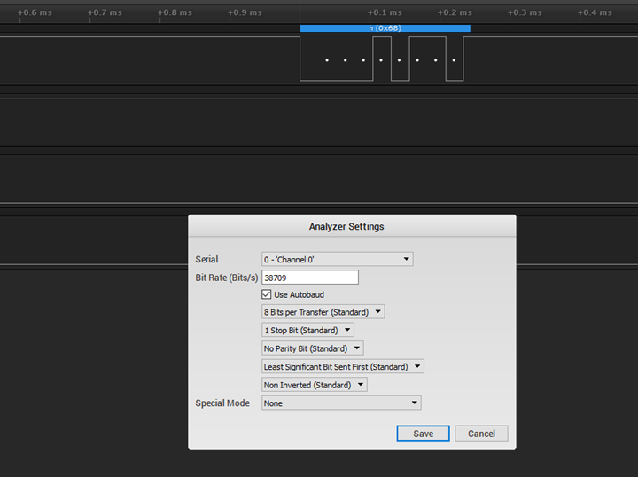

I am writing an application that needs to change the uart baudrate at runtime several times. After some infructuous work with a generic zigbee application i decided to go back to the Wireless UART Example.
The wireless UART has an option to change the baudrate at runtime when the application is running. It supposed to make a cycle between 1200, 2400, 4800, 9600, 19200, 38400. The application starts with 38400 when it passes to Application mode.

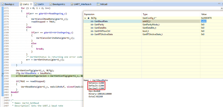

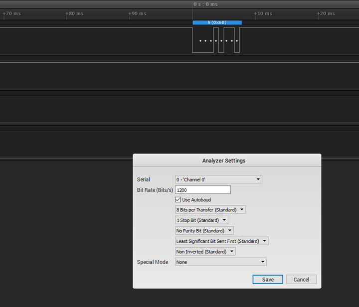

Later when the user press SW4 for the first time, the application cycle runs to the next baudrate (1200).

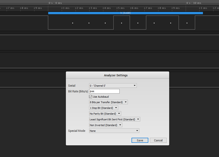

When the application cycle for the second time, the UART baudrate stares at 844bps when it supposed to be at 2400.
Here we measure the baud rate with the logic analyser and we get

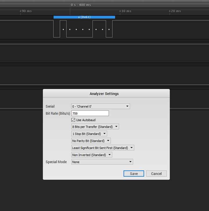

At a third time with the SW4, the UART cycle runs at a 759 baudrate where it supposed to be at 4800.
After the UART gets this baudrate (759bps) the application won't change its baudrate any more.

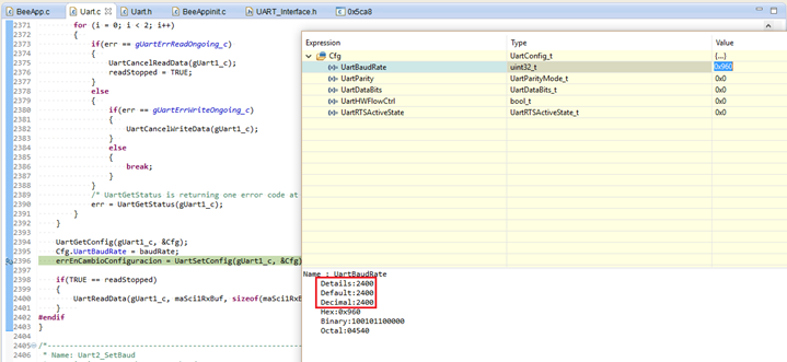

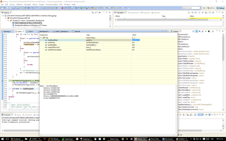

The UartGetStatus function returns 0x00 (everything ok) after each change.
Something to note is that the UartGetConfig function doesn't return the real UART baudrate, but the other parameters.
This issue is present either working with IAR Embedded Workbench form ARM (we use version 7.10) and the Kinetis Design Studio 2.0 or 3.2.

The error seems to be related to some configuration lines of the baud rate registers.
In the UartSetConfig function located in UART.c, please comment the following lines of code:
       mUartModule[UartNumber].UartRegs->BDH = 0x00;
       mUartModule[UartNumber].UartRegs->BDH |= (uint8_t)((mUartSBR >> 8) & gUART_BDH_MASK_c);
Then, add the following line of code instead:
        mUartModule[UartNumber].UartRegs->BDH = (uint8_t)(((mUartSBR >> 8) & gUART_BDH_MASK_c)|((mUartModule[UartNumber].UartRegs->BDH)&(~gUART_BDH_MASK_c)));
The reason why the first two lines do no work it’s because the only way for the UARTx_BDH register to change is until the UARTx_BDL is written; when the code has two consecutive changes in the BHD register it will only be taken into account the last one if it’s followed by the write of the BDL register.
The new line has a mask to clear the register of the last configured data and writes the register with the new data.
