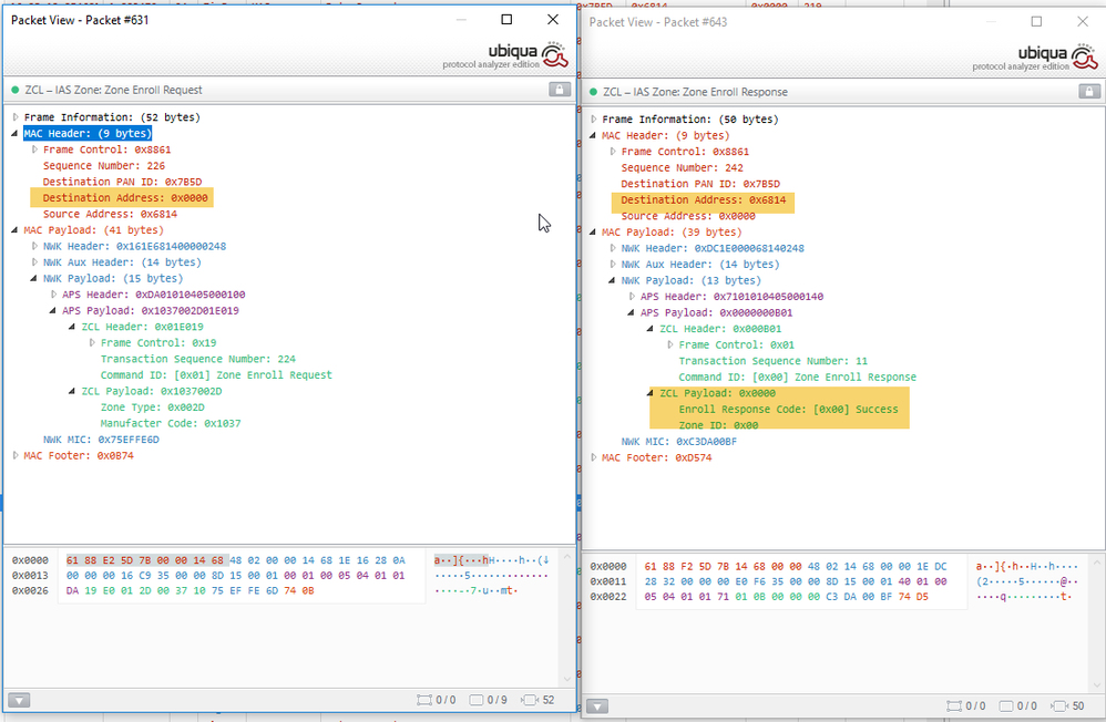

First presence sensor connect to coordinator successfully including enroll request/response and I checked presence sensor notify IAS zone status changed to coordinator.

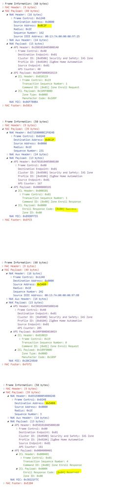

When I tried to connect another presence sensor to same coordinator, however, I found coordinator send enroll response code to 0x04 from enroll response message.
This presence sensor does not send message, which IAS zone status changed, and I think that was caused coordinator does not send enroll response message with success(0x00) response to the sensor.

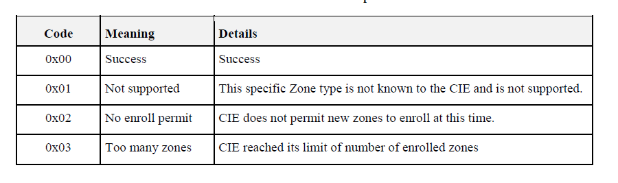

Could someone let me know why coordinator send enroll response message with 0x04 response code and what does this response code means?

Hi Minjeon,
Could you please provide capture in the air? The sniffer log.
I want to confirm if the 0x04 is not the zone id. These are the enroll response code.

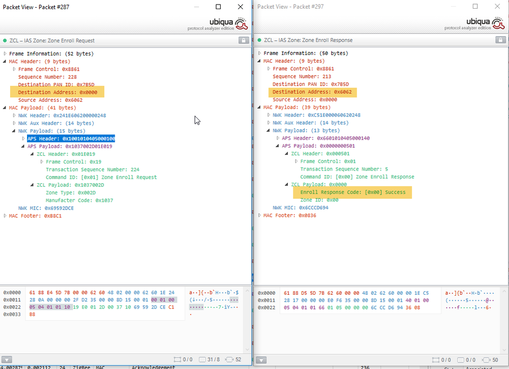

minjeonglee
Hello Mario,
Thanks for your reply and I am attaching screenshot for captured packet in the air.
You can find 2 pairs of enroll request & response.
First enroll procedure was finished successfully but send procedure was failed with unknown response code.

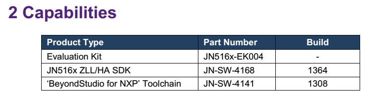

I found original JN-AN-1223 SW, which is compiled from our side, also has same problem and I think this installed SDK caused this issue.
I am looking for JN-SW-4168 SDK Ver.1364 to compile JN-AN-1223 Ver.1001, but I cannot find page to download SDK.
Cloud you let me know how to download JN-SW-4168 SDK Ver.1364?
I also download latest SDK Ver.1620 and I checked that JN-AN-1223 Ver.1001 is not compiled with latest SDK as below.

mario_castaneda
Hi Minjeong Lee,
I ran some test, I used the JN-AN-1223 Version 1014. SDK JN-SW-4168 Build Number 1620.
I created a Zigbee network, joined 2 sensor devices, both devices are Enroll correctly.
We currently provide the SDK Version 1620. As you know, we have fixed some issues that we found.
I also download latest SDK Ver.1620 and I checked that JN-AN-1223 Ver.1001 is not compiled with the latest SDK as below.
The JN-AN-1223 is not compatible, you must modify the AN to compile. I suggest downloading the latest version  JN-AN-1223 1014.
