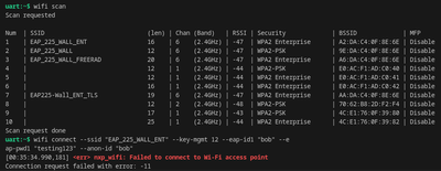

Hello
Thanks for this info its very helpfull. However could it be that this is not for all boards?
zephyr
When i try using the RW612 in zephyr this is my result:
Here i used the "wifi/shell".
NXP MCZXpresso SDK 24.12.0

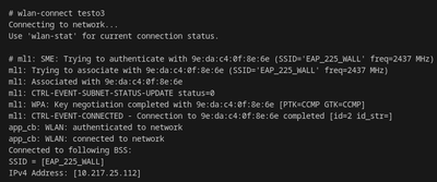

I know the board can do it and that my net is correctly configured since in the NXP SDK i see:
So as of now it seems that the RW612 definitely supports the authentication type.
However i am still struggling to reproduce the connection when using the zephyr SDK. Would it be possible to elaborate what you mean by "it is supported in WPA2 mode".
Is there a NXP wpa2 Kconfig or something?
Again thanks for helping me out
