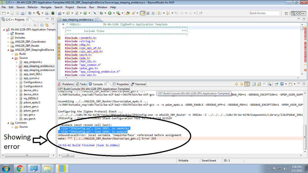

dheerajsawant
Contributor V
Hello Sir,
I am using AN-1229 ZP_Application_Templates.
I am also facing same problem. some times its work correctly else zps_gen.c files started showing error.
i am getting all the time below errors please help me to make it successfully.
File "ZPSConfig.py", line 2897, in <module>
File "ZPSConfig.py", line 1868, in outputC
Waiting for your reply.
Thank You
