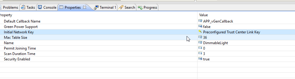

My first question is how to do this in the app.zpscfg with the configuration tool.
I tried to add the keys (increased the APS Key table size to 2):
Zigbee Pro->Router "DimmableLight"->APS
and add 2 children (Preconfigured Key) with the key as value.(dont know why it also ask for a IEEE Address)
But that generates some invalid code in zps_gen.c (wont compile due to the errors):

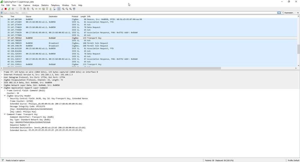

Yes i put the Philips Hue in permit join mode (with the app).
But without the keys i manually put in the JN5168 serial output gives an error in network join 173 (0xAD) according to JN-UG-3113 this is a security key error.
And I found a project on github for ZLL not Zigbee 3 that used the set initial security function with the same keys I tried in my first post.
But I also captured Zigbee traffic with Wireshark and a USB sniffer, and one of the first messages form the Philips Hue is a Transport Key and that is the key:
0x81, 0x42, 0x86, 0x86, 0x5D, 0xC1, 0xC8, 0xB2, 0xC8, 0xCB, 0xC5, 0x2E, 0x5D, 0x65, 0xD1, 0xB8

mario_castaneda
Hi Youp,
The transport key could change if the device joins to the Zigbee network, but the Coordinator(Philips Hue) will send the transport key, that is encrypted by the Zigbee Alliance Key.
The JN-AN-1218 has the Zigbee Alliance Key. Could you please provide the sniffer log that you have.
Mario

youpko
Hey Mario,
As requested here is a capture that i made, and as you can see Wireshark decrypted the message with the Philips Hue key not the zigbeealliance09 key.
(The last 2 rows in the Zigbee Security  Header (key/key label) is the key that Wireshark uses to decrypt the message)
And the Transport key itself indeed changes.
After checking other message I see that all messages are encrypted with the Philips Hue key.

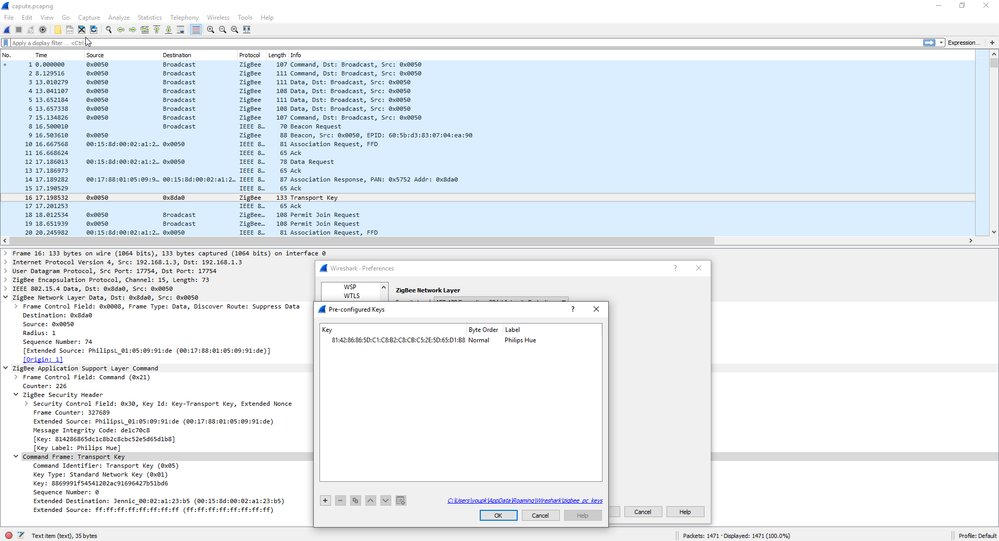

mario_castaneda
Hi Youp,
Could you please attach the complete sniffer log?
As I can see the coordinator is accepting the device. The transport key is correct, but Wireshark is using the Zigbee Alliance key to decrypt the packets in the air.
Mario

youpko
Hi Mario,
I don't have the ZigbeeAlliance09 key in Wireshark only the Philips. That is why I am sure that I need to put the Phillips Hue key in the JN5168 zigbee config.8fdb387b43.png
As I said in the previous post Zigbee Security Header -> Key is the decryption key that is used. an not the ZigbeeAlliance09.
And I know that if i put the Philips Hue key into the zps_gen.c file the JN5168 module will join the Philips Hue network.
But to get back to my question how do i put that the Philips key in the config.

8,307件の閲覧回数
mario_castaneda
Hi Youp,
I'm sorry for my late reply. The Preconfigured key is no longer a supported feature.
You can use ZPS_eAplZdoAddReplaceLinkKey and zps_vAplSecSetInitialSecurityState instead.
ZigBee 3.0 Stack User Guide
Sorry for any inconvenience.
Mario
