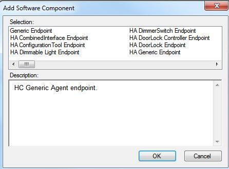

4. You may add endpoint directly in code but it will involve modifying several files and variables. I would recommend you to do it from BeeKit solution explorer instead. You should simply right-click on Endpoints and select “Add Software Component”, then simply select the endpoint to add.
