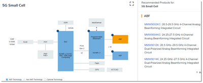

Which NXP solution I would select if I want to build the RU for 5G Small Cell?
2,744 Views
Alex_Hu123
HI NXP expert:
      like the Title ’ Which NXP solution I would select if I want to build RU for 5G Small Cell RU? ’
     could you give me some suggestions , like the part number of ICs and the part number of EVMs of them?
     thank you very much.

       i have looked up the Web-link that you send before.  but their is less information about LA1200 or Solution of Sub-6G.  do you know the part number of the EVM(Evaluate Module) of them? @diazmarin09

Hello Alex,
Thank you for using the NXP communities.
I am afraid that we do not have enough information about LA1200 yet as it is in preproduction status.
Are the following devices useful for you?
WLAN Front-End ICs and Modules
David

Hello Alex,
I hope all is great with you.
First, I would like to recommend the following DEMO that might be useful for you.
5G Integrated Small Cell
So, please refer to the block diagram in order to review all the recommend products. For example, if you are interested on ABF, please click on the block for further information and recommendations:
I hope this information will be useful for you.
