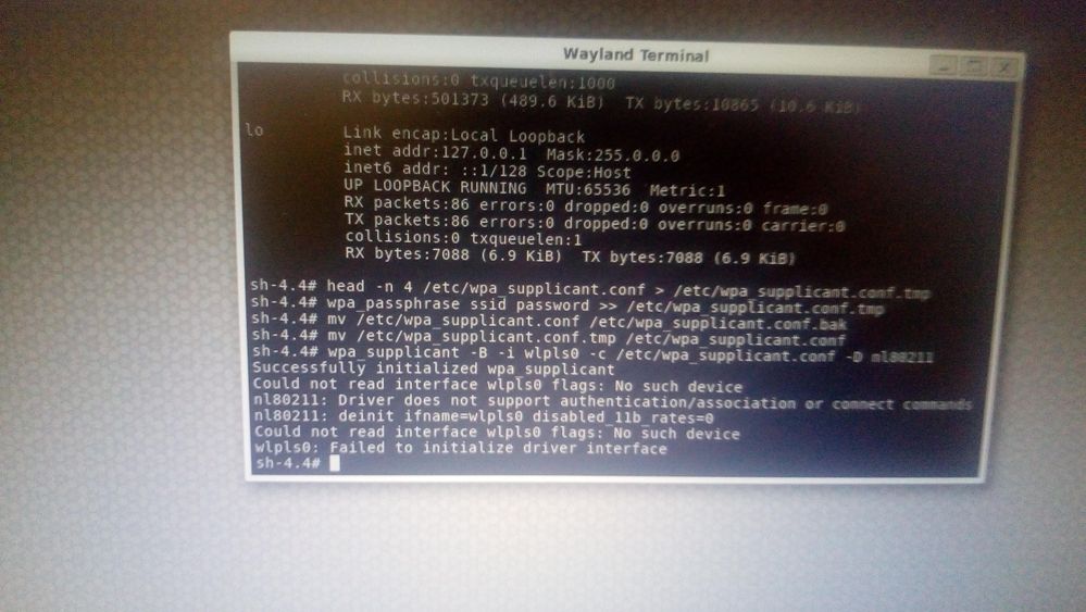

I'm trying to establish  connection between imx8 and mobile using wpa_supplicant. but when i give ifconfig command it results l0 and eth0 and no wlan0. i have gone through imx reference manual, from 4.12.2.5 configuring wlan from userspace,  i tried all the commands , but still i get error like this.  help me to come out of this.IMG_20191016_193611151.jpg

    I followed murata user manual and done all the steps to build the wireless layer  in image , and still i can't find WLAN0 in my ifconfig.

Have you checked "ifconfig -a"? The interface may be present but is down? By default ifconfig only displays the "up" interfaces.

one can check additional linux documentation on wifi vendor portal
wireless.murata.com/eng/products/rf-modules-1/wi-fi-bluetooth-for-freescale-i-mx.html
