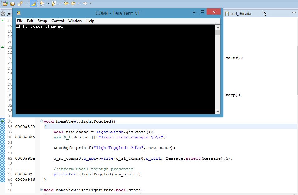

Hey support,
Looking to see if someone can point me in the right direction. I have another board that is writing a message via UART when pressing a toggle button on a touchscreen.
The function in this board looks like this with the bold lines related to UART sent message:
void homeView::lightToggled()
bool new_state = lightSwitch.getState();
uint8_t Message[]="light state changed \n\r";
touchgfx_printf("lightToggled: %d\n", new_state);
g_sf_comms0.p_api->write(g_sf_comms0.p_ctrl, Message,sizeof(Message),5);
//inform Model through presenter
presenter->lightToggled(new_state);

johanandrade
Hi Ovidiu,
Thanks so much for the detailed explanation. Yes I am using PTC6/PTC6 as the serial communication UART between the R41Z and the touchscreen board SK-S7G2.
The void BOARD_InitLPUART(void) function already had the same configuration as you provided so didn't need to do anything there it seems.
I'm now writing the application part for static int8_t SHELL_LightCb. I've been trying a similar approach as when I was using the SW4/SW3 to handle the events.

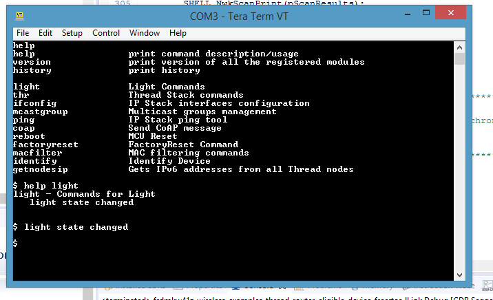

johanandrade
I've applied the application code but using the touchscreen device toggle button is not triggering the event at the moment. To check if the functions are working correctly I've been testing the shell command via Tera Term.
Typing the "light state changed" command triggers the event and turns on the remote LED. I'm wondering if my baudrate settings are incorrect. There are several .baudrate lines available in the mFsciSerials structure. The one I set to 9600 is for an interface type of gSerialMgrUSB_c. I've noticed in the seriallnferfaeType_t structure available in SerialManager.h there is a "gSerialMgrUart_c"  available. Should I be using this one instead of USB or is there a configuration available inside app_int.c already? Thanks as always.
